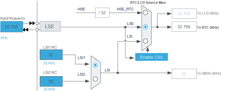

I'm using the internal RTC of the STM32WB55. When the MCU is running the RTC works normally : the calendar can be set and the time is running correctly. When i shut the MCU power down (but still have the VBAT up), and turn it up again, the calendar of the RTC is reset.
I have cleaned the init generated by cubeMX and tried to use a light initialization (NVIC and clocks) when the backup register flag is set but nothing worked:

)RTC config :
What should I have in my MX_RTC_Init() ?

2022-10-19 8:03 AM
Show.
Make sure there is no backup domain reset before that, e.g. related to LSE setup.
Or simply ditch Cube altogether and write your own program.
