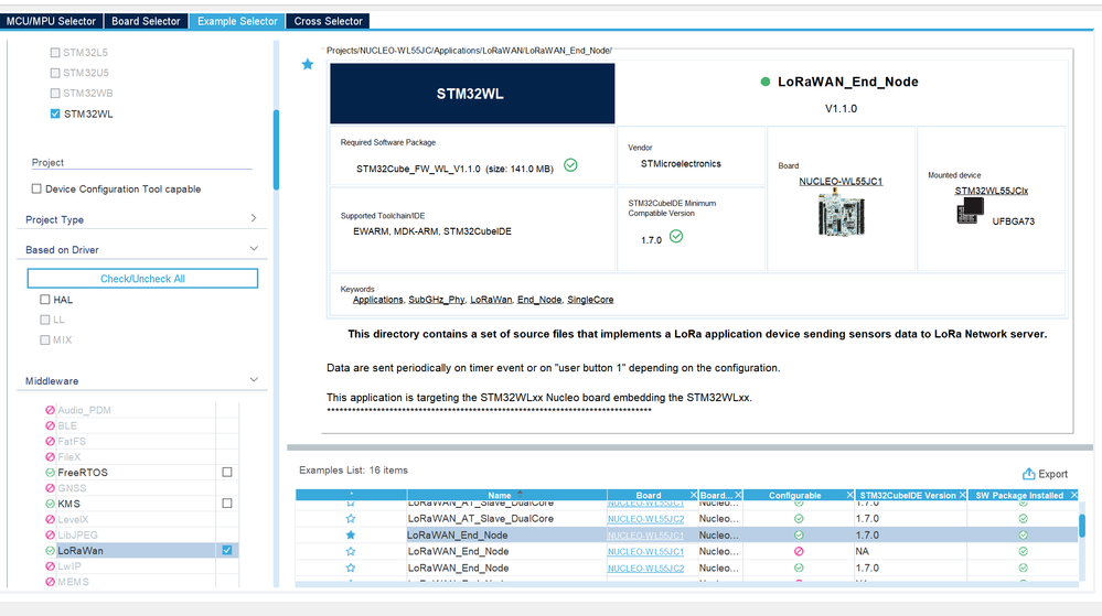

Shown below is the precise example project I am using:

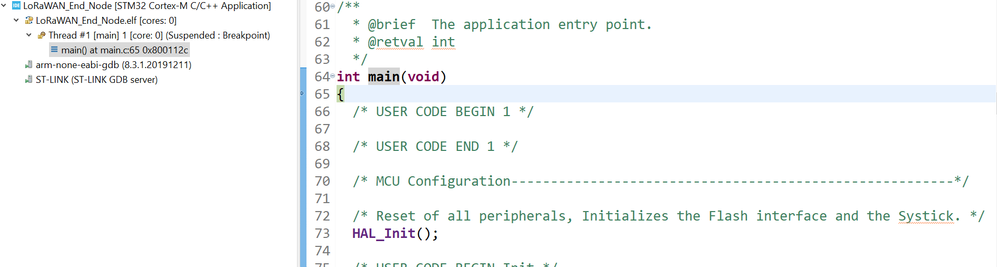

This is the debugger view, with the program halted at main(), right before I click run:

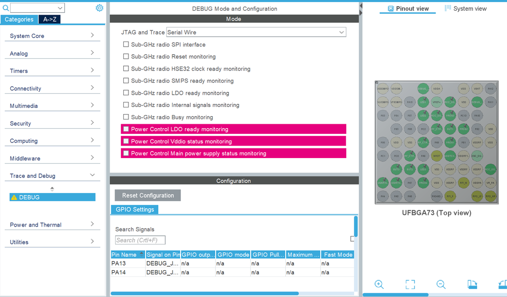

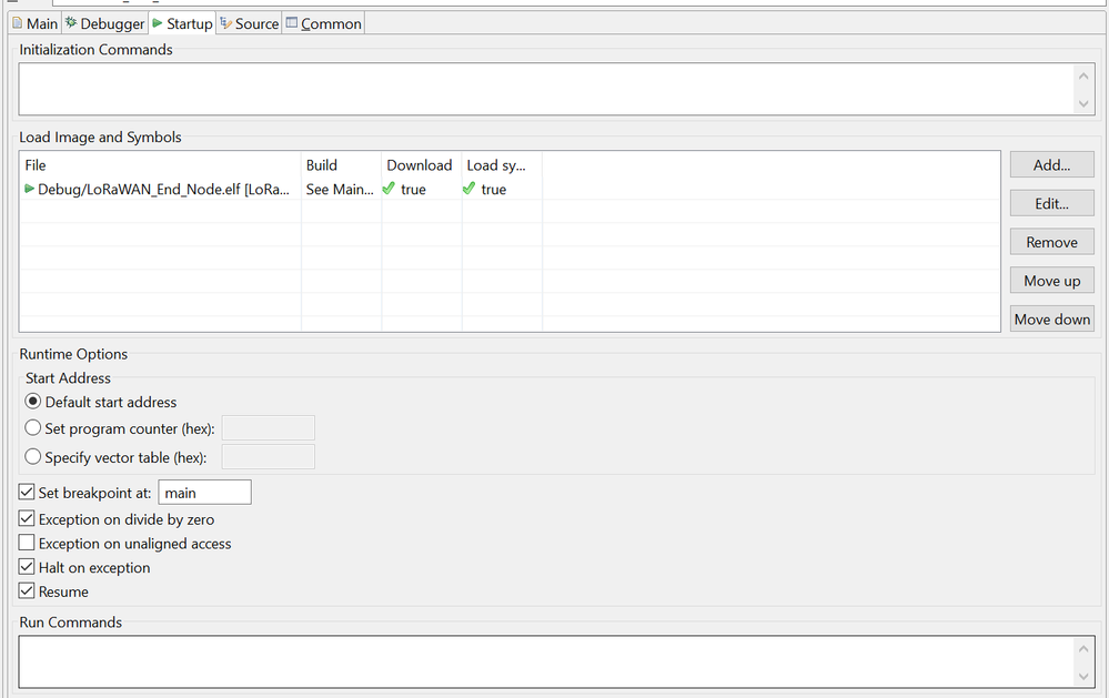

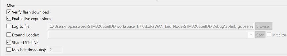

Here is my CubeMX configuration. I've tried serial wire, JTAG, and disabled:
I know that the M0+ core should be the core that most efficiently processes the LoRaWAN stack, but I've run this project before on the M4 core successfully, but am not sure what has changed since then, as I don't have that project anymore.
What am I missing?
Thank you to anyone that can help. I'd appreciate some guidance from the ST's FE's or Application Engineers, if that is possible.

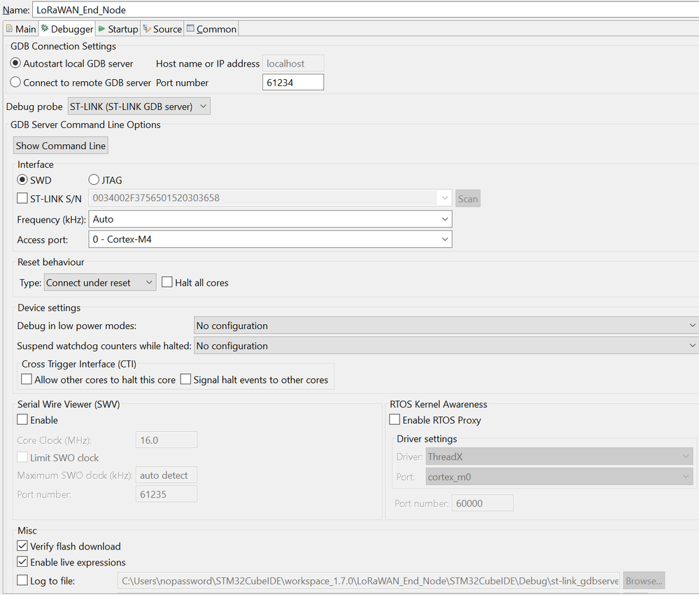

Edit: Here are my debug configurations as well

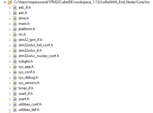

Thanks! Where can I locate the sys_conf.h?
2022-02-10 6:37 AM
2022-02-10 6:47 AM
Thanks! Solved!
