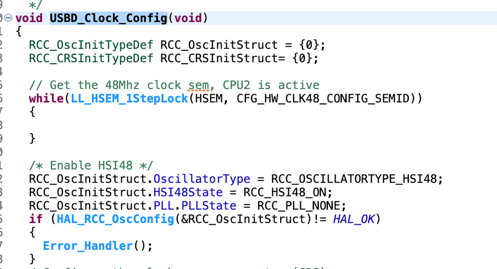

I'm developing an application which uses both USB CDC and BLE, using an stm32wb55cg USB_Dongle as my current target board. I've started by building two separate applications using STM32CubeMX(STM32Cube_FW_WB_V1.12.0) and stm32wb5x_BLE_Stack_full_fw1.12.0:
1.CDC be used for the application communicating with PC
2.A BLE P2P client
Both of these work fine on their own. But if I build an application that includes both components, the USB cdc device will not enumerate properly.
I also found that if I commented out UTIL_SEQ_Run(UTIL_SEQ_DEFAULT); , USB worked fine, and vice versa.

You should poll Sem5 until granted before configuring the clock for USB. See AN5289, figure 9. Else M0 will switch it off.
2023-05-25 2:28 PM - edited 2023-11-20 9:19 AM
This was the answer! Thanks!
