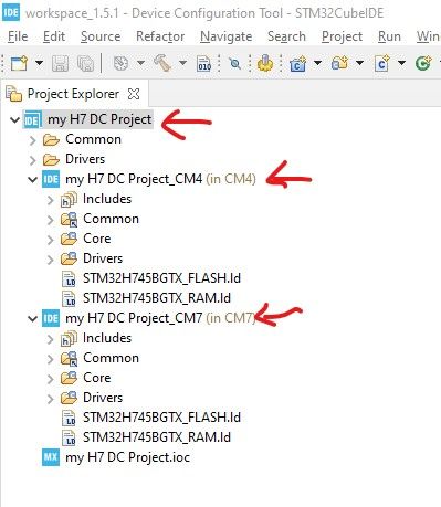

"Hierarchical" projects looks like:
Here I've "my H7 DC Project" which is my "main" project container.
But takes care x2 other projects are promoted (appplicative ones) ... one per cpu (here my H7 device is a dual cpu one including x1 Cortex M4 plus x1 Cortex M7)
Closing one of them is not closing others ... you have to close all by yourself.

You are right. I only close the top project and not the subordinate projects.
Nevertheless, if I close the top project, the others below it with the other cores should also close, right?

" if I close the top project, the others below it with the other cores should also close, right?" ... from common Eclipse behavior answer is: no.
Eclipse is not managing by itself action propagation thru a "hierarchical" project structure.
So if STM32CubeIDE i would not say bug but we may ask for feature request. Please rely on "Idea Zone" to promote it I guess.

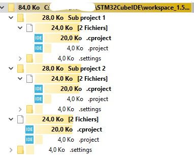

I've just got a try with some Eclipse + CDT vanilla projects ... "sub projects" are not closed closing "root" one (2020-12 Eclipse basis)
Consider if doing a trial by yourself following file system structure:

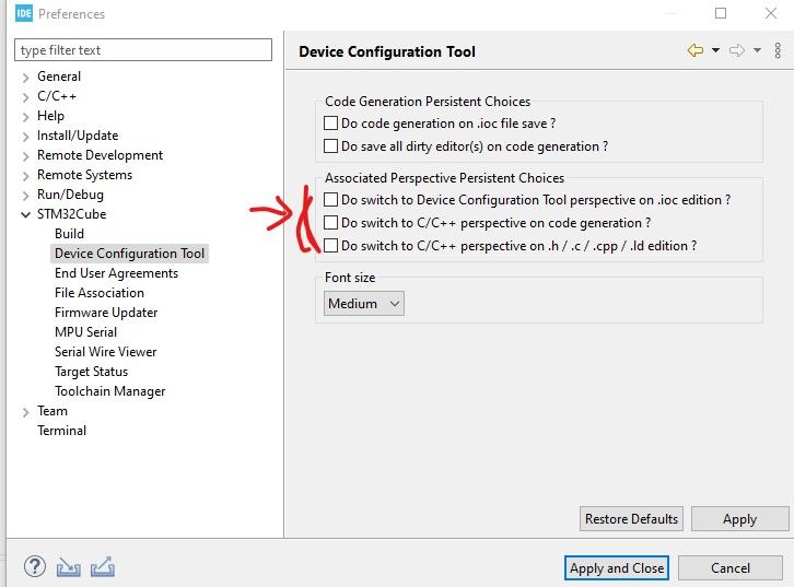

2) About ioc editor popup I agree from my memory such has been reported already Thanls some post on such forum.
Sounds like a well known issue ONLY if MacOS. Related answer is claiming known issue but sorry still Eclipse native issue related managing perpective events not the same if MacOS ... Works like a charm if Linux or Windows.
By then way as I may be MacOS end user too ... I'm relying on proper preferences to get rid of such issue. Let's play with:
