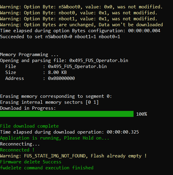

1.Delete the existing wireless stack:
STM32_Programmer_CLI.exe -c port=swd mode=UR –fwdelete
Result:

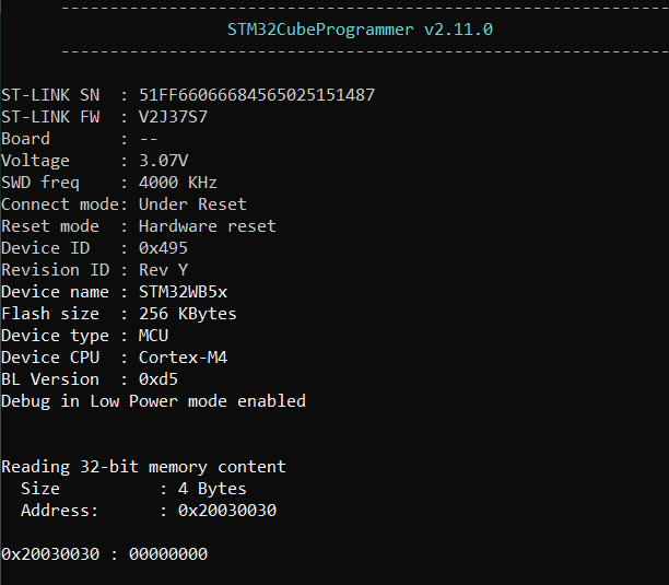

2. Read The FUS version
STM32_Programmer_CLI.exe -c port=swd mode=UR -r32 0x20030030 1
Result:

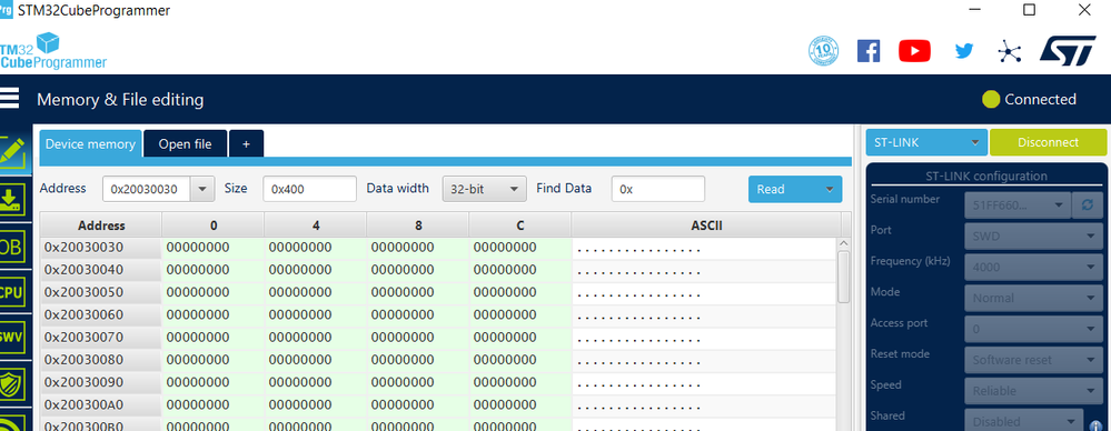

To ensure this, I've checked the address 0x20030030 with STM32Cube Programmer, it is 00000000.
My question is why after fwdelete I got -> 0x20030030 : 00000000 ?

I think that even before deleting the wireless stack, reading the value at address 0x20030030 would give you 0. When using the SWD port, the FUS version is not located at this address. This works in DFU mode.
I would recommend to use the latest CubeProgrammer version which manages to properly read the FUS version whatever the debug port used (USB or SWD).
