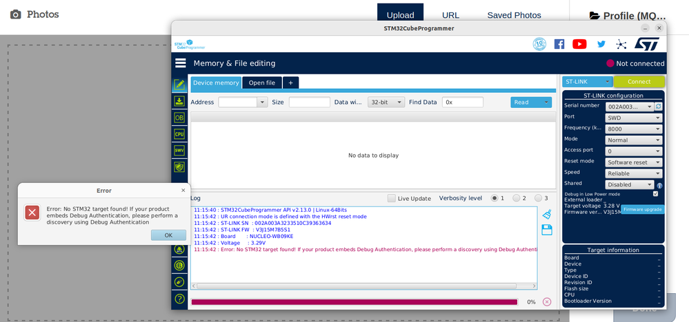

I used a MB2032-WB09-B02 on MB1801D for several times, flash in CubeIDE was always OK, though debug prompted error read data every time, then the next day when I used it again, it didn't work, I couldn't flash image into neither in IDE nor Prog, the prompt:
my question is: how to discovery using Debug Authentication?

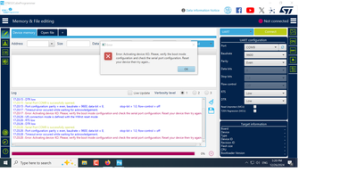

I identified the settings described in UM3345, the first 2 items is OK, for item 3 and 5, I didn't use ST Bluetooth® Low Energy sensor mobile application on a Bluetooth® Low Energy compatible mobile device from the App Store or Google Play, I just turn on Bluetooth on the mobile phone and want to find the WB09KE, did this matter?

I got this:

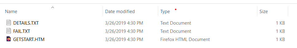

When I changed into other windows PC, it was shown as an USB driver with label: "NOD_WB09KE", and there are 3 files in it:
and the content of "FAIL.TXT":
The interface firmware FAILED to reset/halt the target MCU
What does that mean?

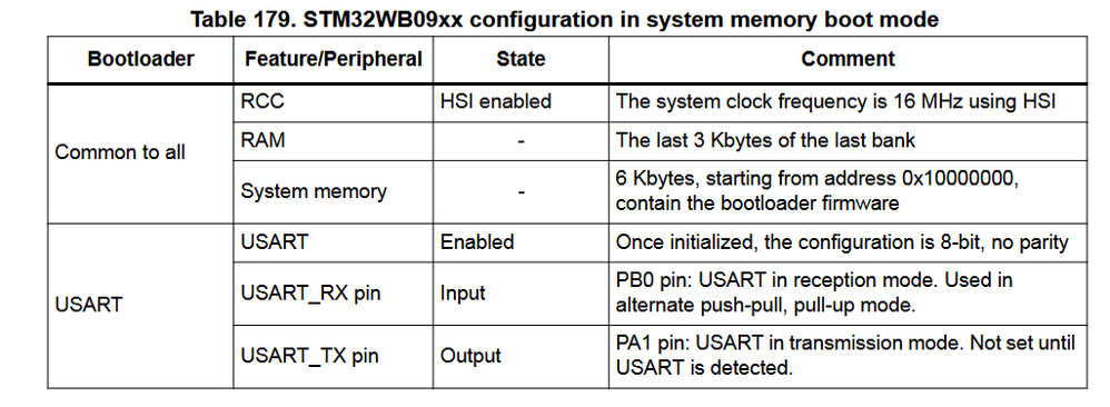

I saw on page 409 of AN2606:
Should I use a USB-TTL or the ST-Link V3 on MB1801D would be shifted to UART configuration when use it in boot mode?
Exactly the same here. How to solve this issue? It seems that is needed other pin in some "state" than only keeping PA10 high under and after reset to start uart bootloader on STM32WB09xxx. But what?
