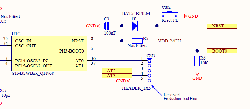

In P-NUCLEO-WB55 schematics, the pins are connected as shown below. I was not able to find much info from datasheet other than that its related to RF functionality. Can i leave it open if i am making a custom board with STM32WB55 controllers?

As written: "Reserved Production Test Pins"
