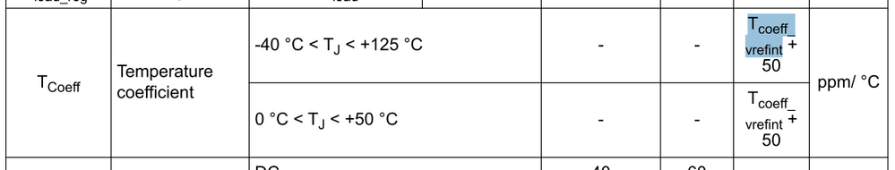

Hello. What is the exact value of T_coeff_vrefint? I'm planning to use internal reference voltage buffer (VREFBUF) output pin in my application.

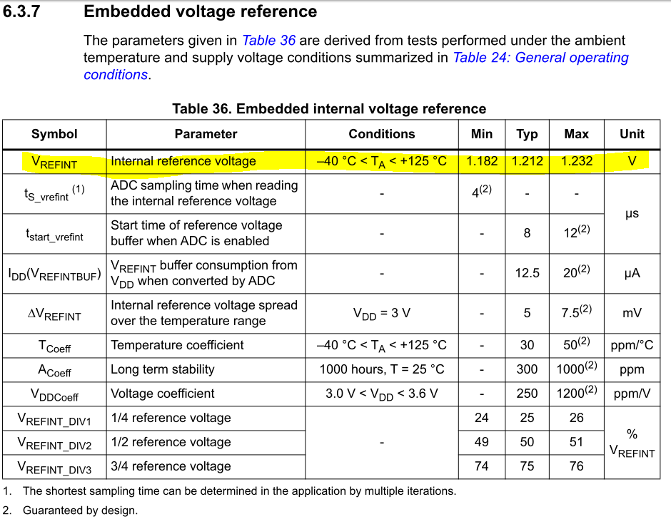

Hi @Paweł Straszak​ ,
Tcoeff_vrefint is provided in the table Embedded internal voltage reference of the same datasheet:

Thank You. I was unable to find this information in the specification.
You are welcome. It is in the datasheet of the product.

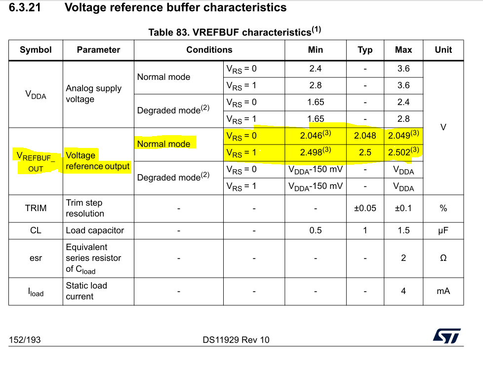

One more question: is V_ref voltage equal to 1,212 V or to 2,048 V / 2,5 V?
