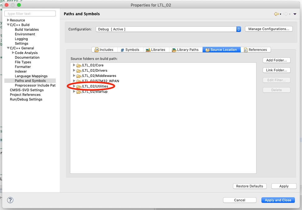

I had the same issue. To resolve it, I have added "Utilities" path in C/C++ General->Path and Symbols->Source Location. Because if you read the complete log, you can see compiler never reads this folder.
This issue exists if you use the standalone CubeMX or the integrated CubeMX wizard in CubeIDE.

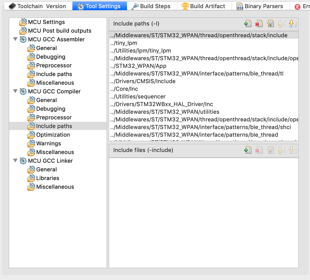

Strange to see ../tiny_lpm here as it is not the right path. The correct path is the one just below it. This may create a conflict.
2019-12-10 8:00 AM
Thank you so much, this fixed the problem! I have been trying to solve this for a while now.
