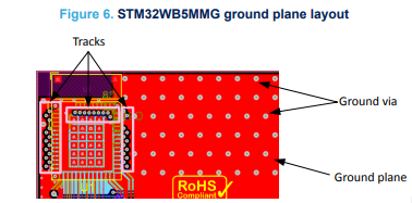

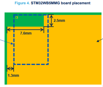

The datasheet of the STM32WB5MMG BLE module describes the placement of the module, as well as recommendations for the ground plane on the right side to the module:
- The module should be placed in the top left corner
- The ground plane should be kept free and provided with vias.

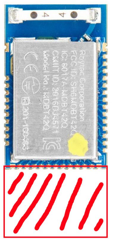

Similar to this board:
Other electronic components would be placed under the module in the red zone.

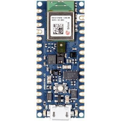

Or like the Arduino Nano33 (but without the pins next to the module):

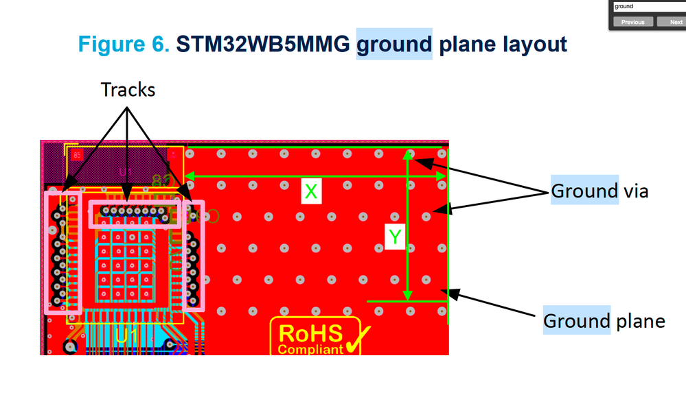

2023-01-23 11:33 AM
I have a similar concern. In the attached drawing (screenshot from the layout notes), what are the minimum values of X and Y that are supported? X is the distance from the right side of the module outwards; Y is the distance from the end of the module where the antenna is located, back towards the pins on the other short side of the module.
