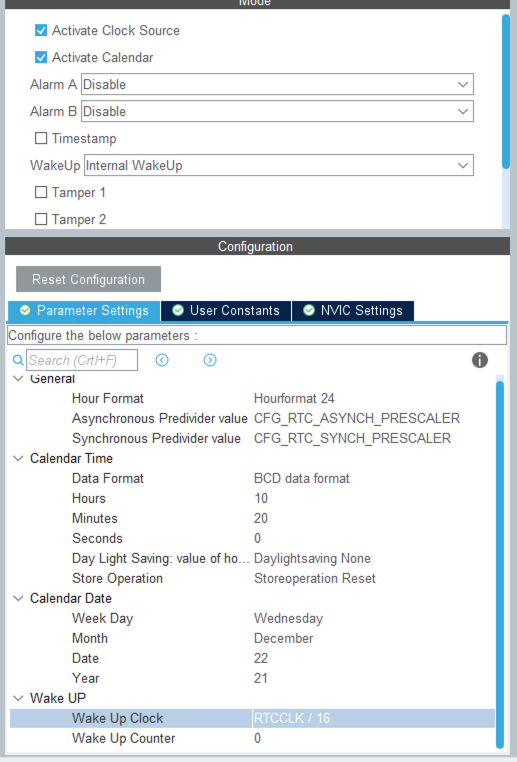

2021-12-23 1:46 AM
Thank you for your reply, I have added some information about my settings.

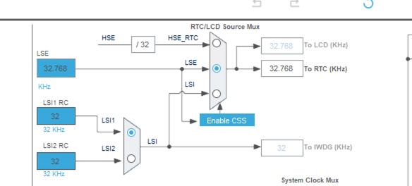

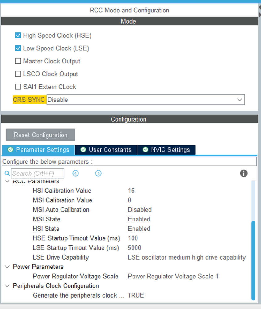

OK, where did you assign which value to
What are your RCC settings for LSE?
2021-12-23 6:49 PM

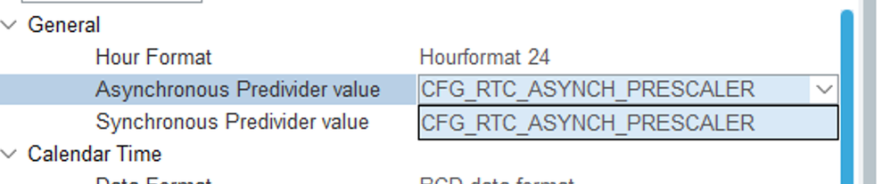

RCC settings for LSE is here. I have tried every option of LSE Driver, but it didn’t work.CFG_RTC_ASYNCH_PRESCALER and
CFG_RTC_SYNCH_PRESCALER is an option of CubeIde, and there are no other options to choose.
#define CFG_RTC_ASYNCH_PRESCALER (0x0F)
#define CFG_RTC_SYNCH_PRESCALER (0x7FFF)

According to your answer, I solved this problem smoothly, thank you very much.
