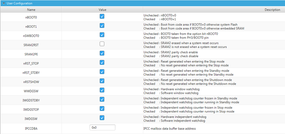

And here are the option bytes, I assume these are default values.
2019-10-16 1:13 AM

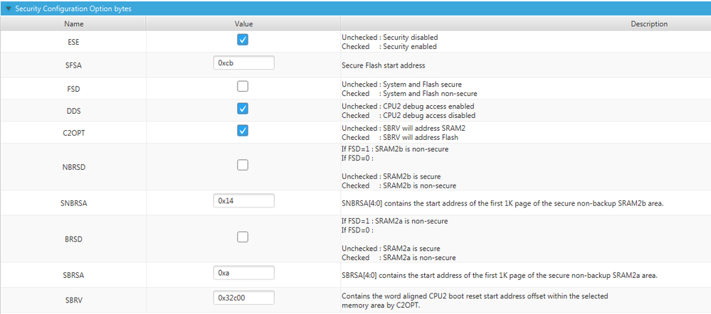

In fact I would like to see the secure option bytes: ESE, SFSA, SBRV, C2OPT, ...
2019-10-16 1:17 AM
@Remi QUINTIN
2019-10-16 2:13 AM
They look good. At least the SFSA is set at a level that can let us confirm that the RF stack is correctly installed. Are you using the new CubeProgrammer V2.2 with the SWD protocol?

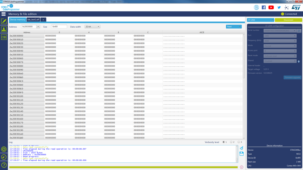

Do you see some data existing in SRAM2a starting from 0x2003 0000 (IPCC data buffers)?
2019-10-25 5:58 AM
@Remi QUINTIN
Updated the CubeProgrammer to v2.2, but everíthing is the same.
From the addres 0x2003 0000, I only see a bunch of zeros, like this:
2019-10-25 6:45 AM
Clearly the RF stacks is not working.

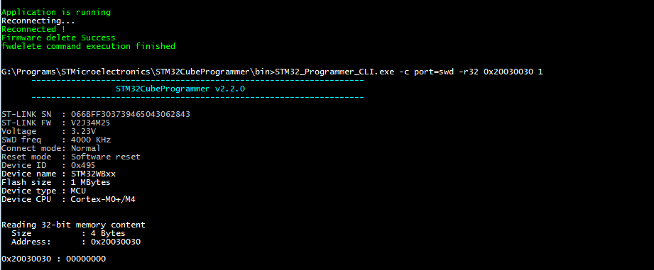

2019-10-25 7:28 AM
@Remi QUINTIN
The -fwdelete was succesful with the new CubeProgrammer, Thanks, but sadly still get 0s from the second command:
