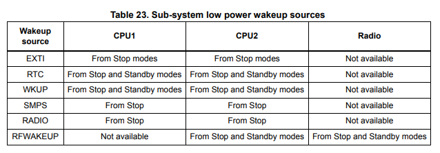

According to reference manual RM0434 (p151), see low power wakeup sources as below:
Of course, it's possible to reach STOP2 mode once the connection is established. When you have a BLE connection up and CPU1 enters Stop2, the system will enter Stop2 between connection interval and will be in RUN mode during radio event. You shall not do anything to control the CPU2 low power mode. The wireless stack running on CPU2 makes sure the lowest low power mode on CPU2 is requested depending on the use case. Basically, you should develop you application on CPU1 in the same way as if it was a single core product (i.e you dont need to care about CPU2 for low power management).
