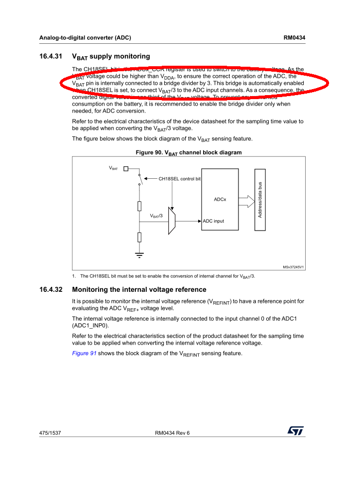

Hi ASiva.1,
Can you please share a screen shot from the datasheet where you find the info :"But, it is also said that there is an internal voltage divider so that voltage to the ADC is 1/3 of the voltage at the VBAT pin"

2020-12-01 7:31 AM
Not in DS, but RM:
Nothwithstanding, the absolute maximum limits still apply, as Peter noted.
Truth to be said, the Absolute Maximum for VBAT is 4.0V - but still more than a LiPo battery will provide.
