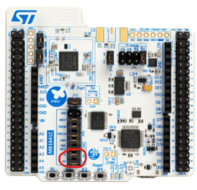

I have found that the D8 and D2 pins on the board are not working for serial communication. I believe this is due to a pin conflict with the on-board ST-LINK debugger, as a table in the board's documentation shows PA9 and PA10 are routed through jumpers to the ST-LINK (JP5 pins 13-14 and 15-16).

Hello @saurabhc @and welcome to the ST Community.
As said @TDK, you just have to remove the two jumpers from the JP5. But, for the arduino connectors D2 and D8, they are connected to PB0 and PB5 (not PA9 and PA10) that can not be set as TX and RX pins of USART1.

2025-08-03 3:43 AM
If you disconnect PA9/PA10 from the ST-Link by removing the bottom two jumpers on JP5, they will be available for use. You will, of course, lose VCP functionality.

2025-08-03 10:04 AM
The TX from the STM32 doesn't conflict, it can output to two Inputs, ie VCP RX Input, and Arduino Transmit Output.
However you don't want TWO pins driving the STM32 RX, so disconnect one of the sources.
2025-08-03 1:41 PM
Thanks for all the replies. I'm able to use it thanks to your inputs!
