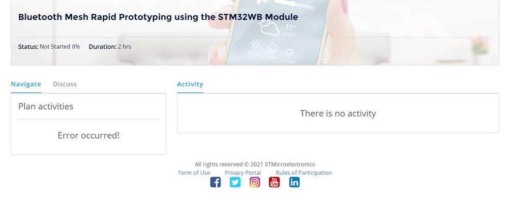

Hi @ALu.3 ,
I suggest you to follow the steps as described in the eLearning WB Bluetooth mesh - 4 STM32CubeWB Bluetooth LE Stack installation.
Relevant details for you start at 1:55.
-Amel
2021-08-12 8:07 AM
Hi @Amel NASRI .
Thanks for the info I will check it out
Angus
2021-08-12 8:18 AM
Hi @Amel NASRI ,
It seems like I already followed the instructions but errors still happen, like FUS_STATE_IMG_NOT_FOUND and Operation exceeds memory limits
Angus
2021-08-12 8:22 AM
Hi @ALu.3 ,
Check this new link please and look for the 4th course WB Bluetooth mesh - 4 STM32CubeWB Bluetooth LE Stack installation.
Or, from navigational bar, go to Academy > eLearning Catalog > General Purpose Microcontrollers > STM32 Wireless BLE > Board installation and Materials overview > WB Bluetooth mesh - 4 STM32CubeWB Bluetooth LE Stack installation.
That is the learning content recently introduced in the Community.
-Amel
2021-08-12 10:35 AM
Hi @Amel NASRI ,
I checked through the video and confirm that I followed the instructions, but errors still come up.
Angus
