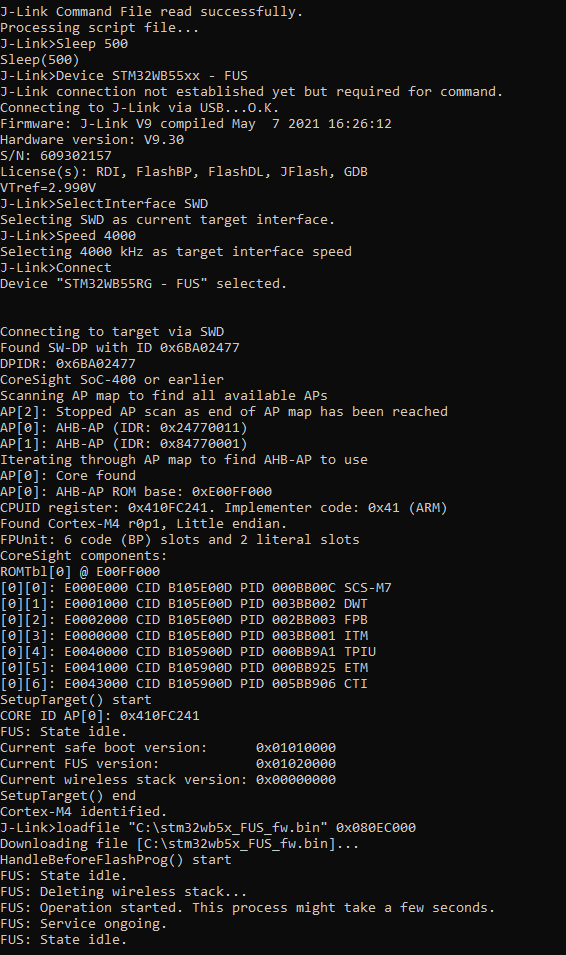

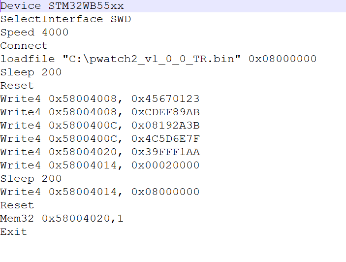

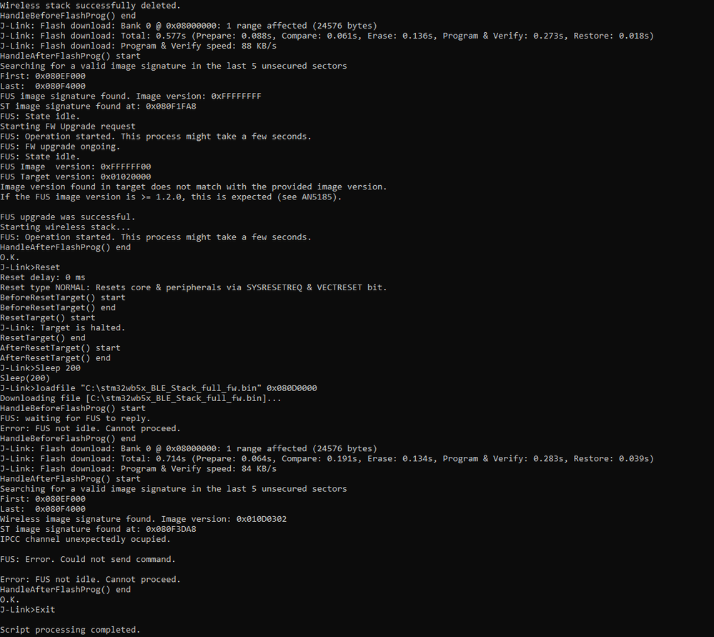

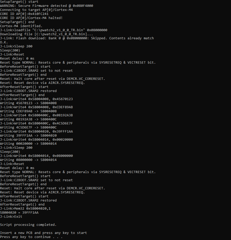

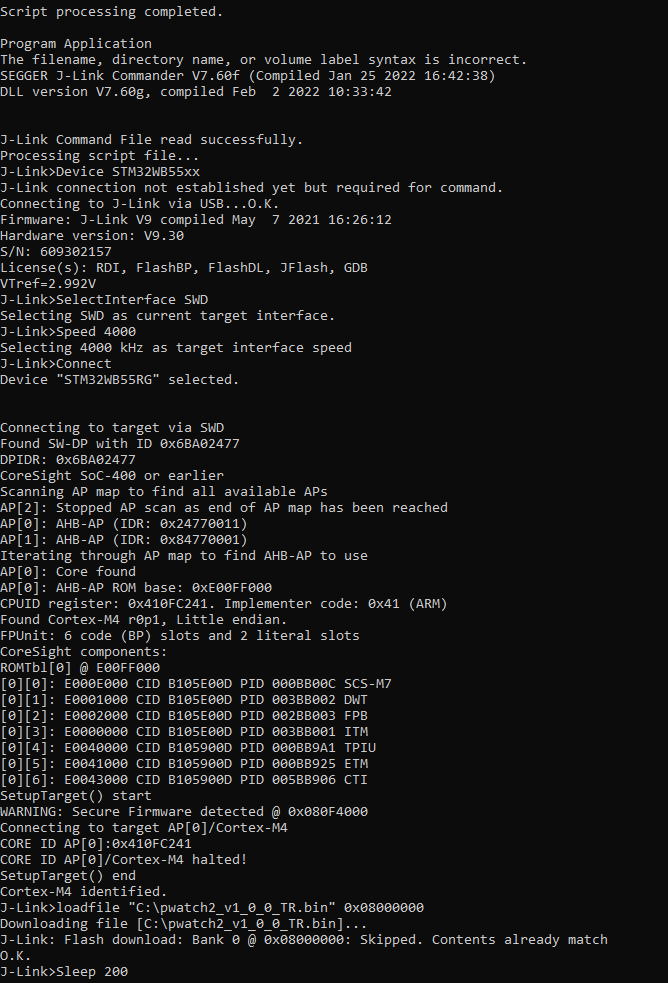

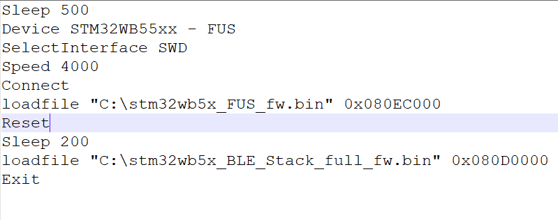

I just had some custom boards with STM32WB55RG and I would like to flash the BLE stack into the microcontroller.
Files I'm trying to install on the device:
But device bluetooth not working. I am sharing the cmd output on the screen. Could the error be that I installed the wireless stack without deleting it?

You can look this wiki page which explains how to update the FUS and the wireless stack for stm32wb55. Do you know which FUS version you already have ?
