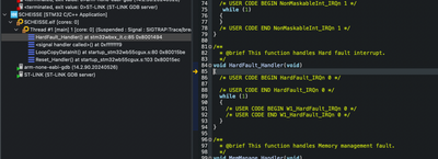

i have a custom board designed which is broadcasting stuff over BLE.
So far i am using the full_stack_fw which works quite well.
In order to turn on extended advertising i wanted to switch over to the full_extended_stack (needed for extended advertisement).
So i flashed the chip with the extended firmware.
After that i created a brand new project in CubeIDE and configured all the things.
Now i try to flash the application but it wont boot up :\
It gets somewhat of a HardFault after turning on BLE WAPN.
If i disable BLE again, it works.. So i am able to toggle an LED for example. No problem. This only occours as soon as BLE is activated.
