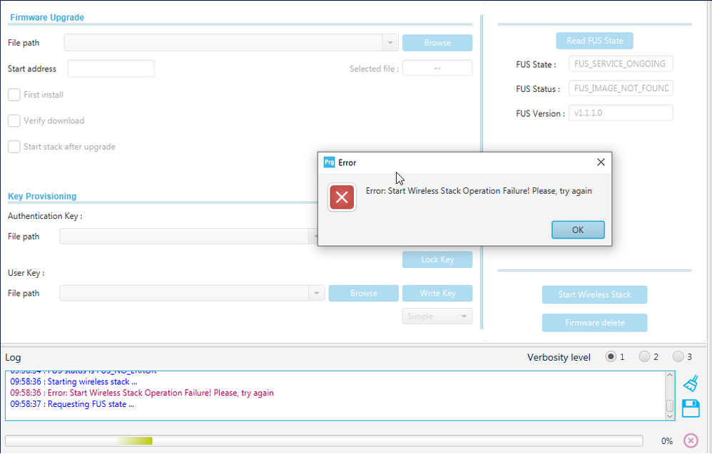

I followed UM2550 section 5: when I get to "Download new wireless stack" I get the following error:
The Copro Binaries do not list this 256K chip in the binary tables; I'm assuming the FUS address is 0x0803A00, and BLE_Stack_full_fw 0x800B000, it's possible I'm not using the correct address for the BLE stack.

OK. You have the most recent FUS version. This is good. Now you need to program the M0+ FW (RF stack).
The error is resulting from the fact that you try to start the wireless stack though it is not installed.
Select the BLE stack = stm32wb3x_BLE_Stack_full_fw.bin file here under this directory: STM32Cube_FW_WB_V1.10.0\Projects\STM32WB_Copro_Wireless_Binaries\STM32WB3x.

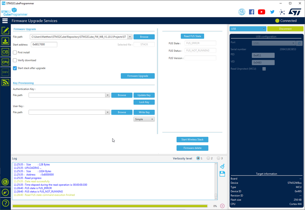

2021-02-15 11:55 AM
For the 256K chip, the FUS is not located in the user area but somewhere higher in the memory not being accessible.
So you should be able to load the RF stack being 40 sectors big at address 0x08040000 - 0x29000 = 0x8017000.
But I don’t expect this to be the reason of the failure.

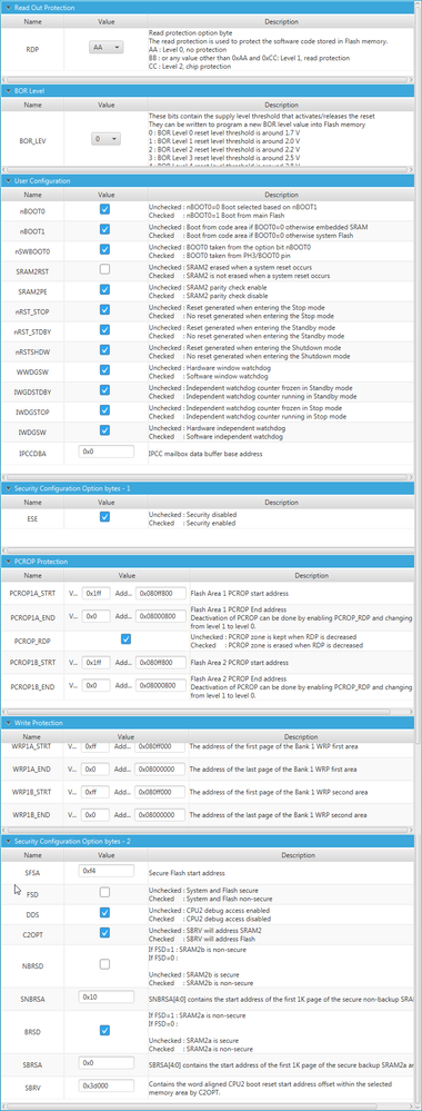

Now could you show me the option bytes?
2021-02-16 8:01 AM

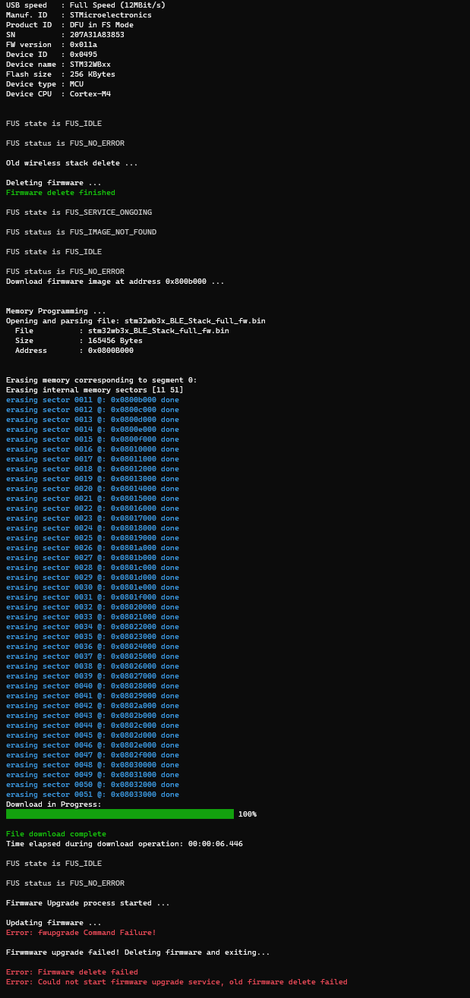

These are the settings I used to update on my new chip:
I get a Warning after flashing: "Warning: Connection to device 0x495 is lost", I attached the log.

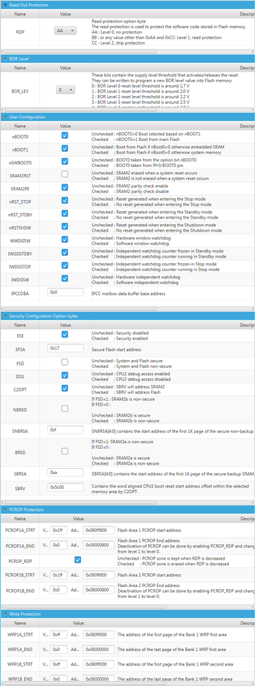

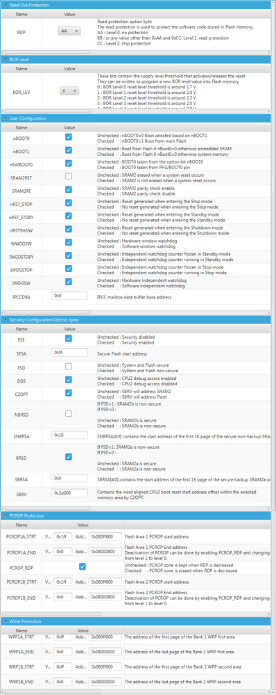

After reconnecting to the DFU device this is what I see for my option bytes:
