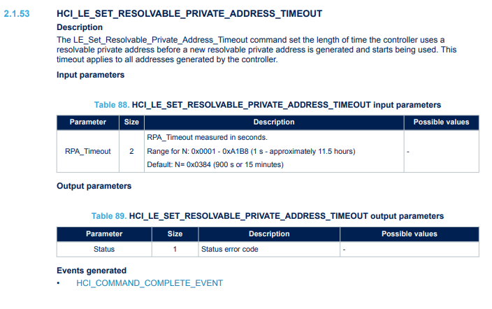

Yes 15 minutes, it's the default time before the controller generated a new resolvable private address. So, after this timeout, you need to restart advertising. You can change this timeout with this function: hci_le_set_resolvable_private_address_timeout.
See the following extract of AN5270 :
