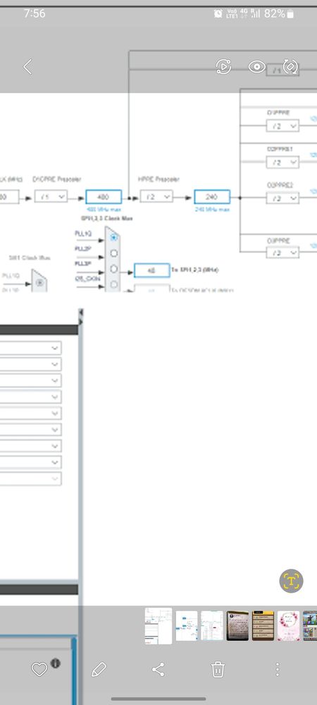

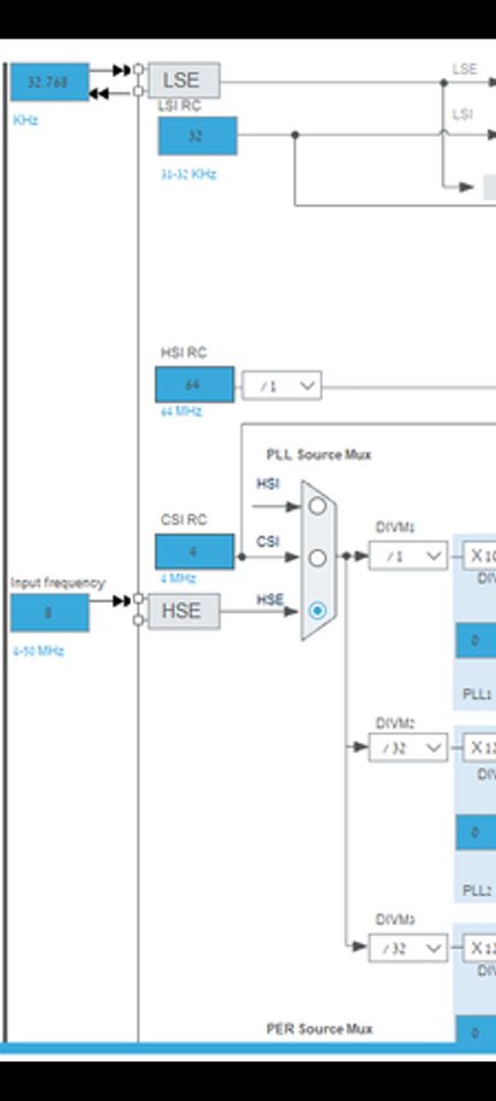

Here is Input frequency.. you can change it according to yours requirements.
HCLK frequency
Input frequency

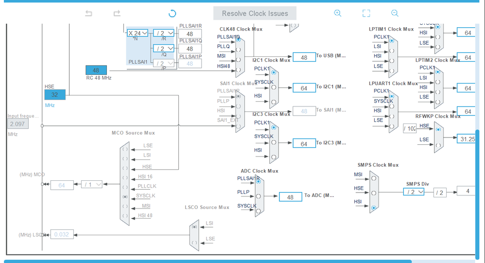

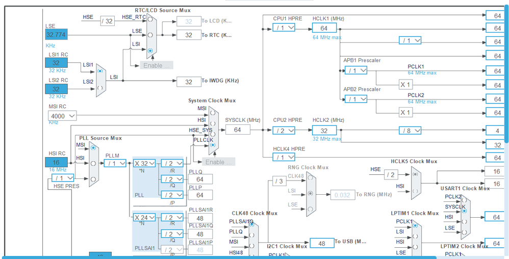

I am sorry, here is the full page (tell me if you can't see well).
For the clock, i don't really do anything, i let the seetings by default, i didn't really know how the clock configuration worked...

It looks like you're using MSI RC as your clock source? That may not be accurate enough as a baud rate clock.
Again, an external crystal (or crystal oscillator) would be best to get the accuracy required for async serial comms

In PLL Source MUX select HSI instead of MSI ... after again you have to select HCLK as maximum.
