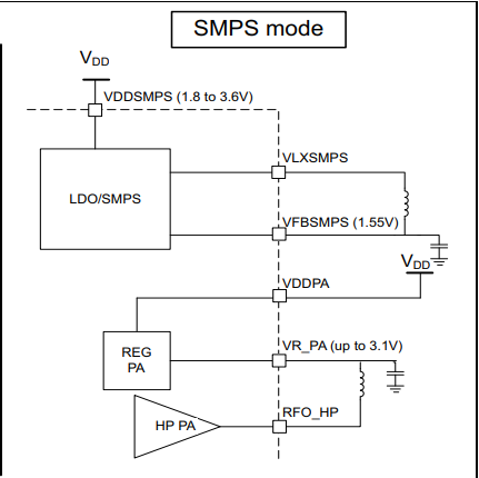

I designed the hardware like the firgure below,

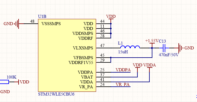

my schematic below,
the VDD connected to the VDDPA pin.
VR_PA voltage is 1.7 - 1.9V.
when Lora transmit the VR_PA voltage is smaller than 3.1V.
Please support me. Thank you very much

Hello @Ngô Vạn ,
Can you tell me if you well configure your software to be in high power (22dBm) ? And if you have well selected the HP output for your measurements ?
Have you measured your output power ?
Thank you for your answers
Best regards
Louis

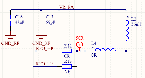

2022-10-11 3:58 AM
In schematic reference file the C17 capacitor's value is 68pF. I tried to replace C17 capacitor's value to 10uF. My application work correctly. What wrong in my design ?Please support me. Thanks
