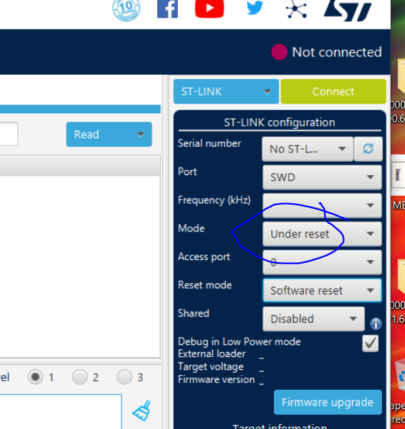

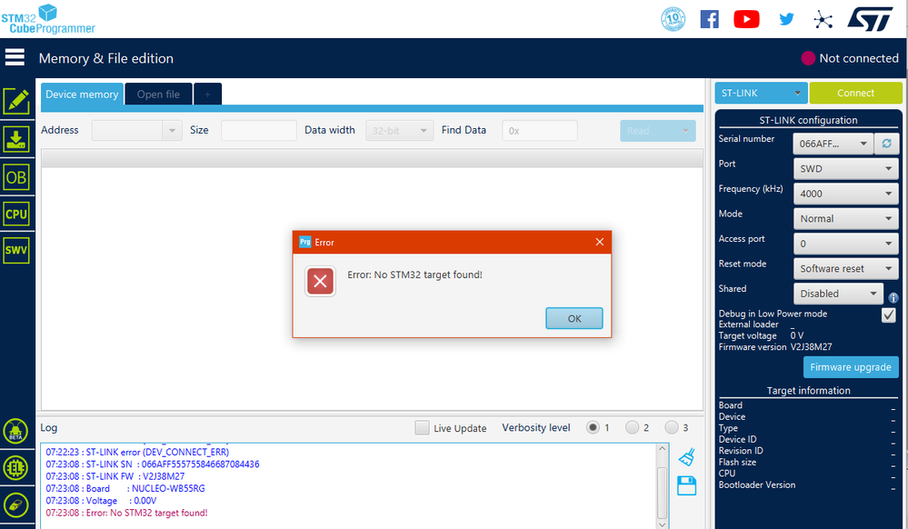

I am using NUCLEO-WB55RG for developing a lorawan project targeted to STM32WB55CG chip. I successfully downloaded the code using Keil IDE. When I was loading the code the windows machine was showing there is 3MB of space. I could run the code and debug. But when I tried to connect the Nucleo again I noticed that the disk size has reduced to 32KB. It has a fail.txt file in it and it says "The interface firmware FAILED to reset/halt the target MCU".
When I tried to load the code from Keil again it says target not connected and The flash download failed and Target DLL has been canceled. I connected it to cube programmer and was getting a target not connected message. I tried another new board and this problem happened again. My two Nucleo boards are useless and is it possible to factory reset the NUCLEO-WB55RG. Why did this happen? Is there anything wrong with the downloaded project? Please do help me to fix the problem. I am attaching the screenshots too.

Its very weird the stlink is detecting 0.00V in the tarjet ....
To flash the factory code again you would need to be able to connect to the MCU first...

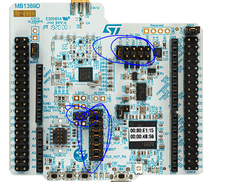

I didn't use cubeMX to generate the code. It was a successfully compiled and tested code from a third party(SDK for lorawan). All the ides and applications were the latest versions. I could update the firmware too using the firmware upgrade option on cubemx. None of the jumpers are removed. Both boards are the same. Thanks
