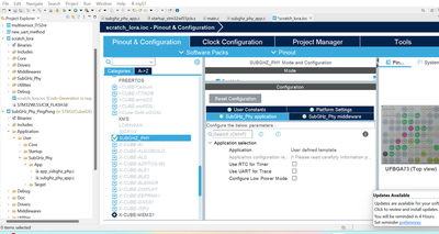

Hello @SSmit.13
If you are looking for a P2P communication using the LoRa technologies. You can select the SUBGHZ_PHY middleware on CubeMX :
For more details, refer to the configuration on this example.
