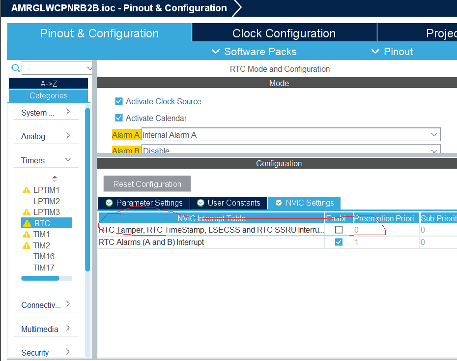

2022-09-13 1:05 AM
I have not enabled
RTC Tamper, RTC TimeStamp, LSECSS and RTC SSRU Interrupts
Is this can be issue of MCU Reset?

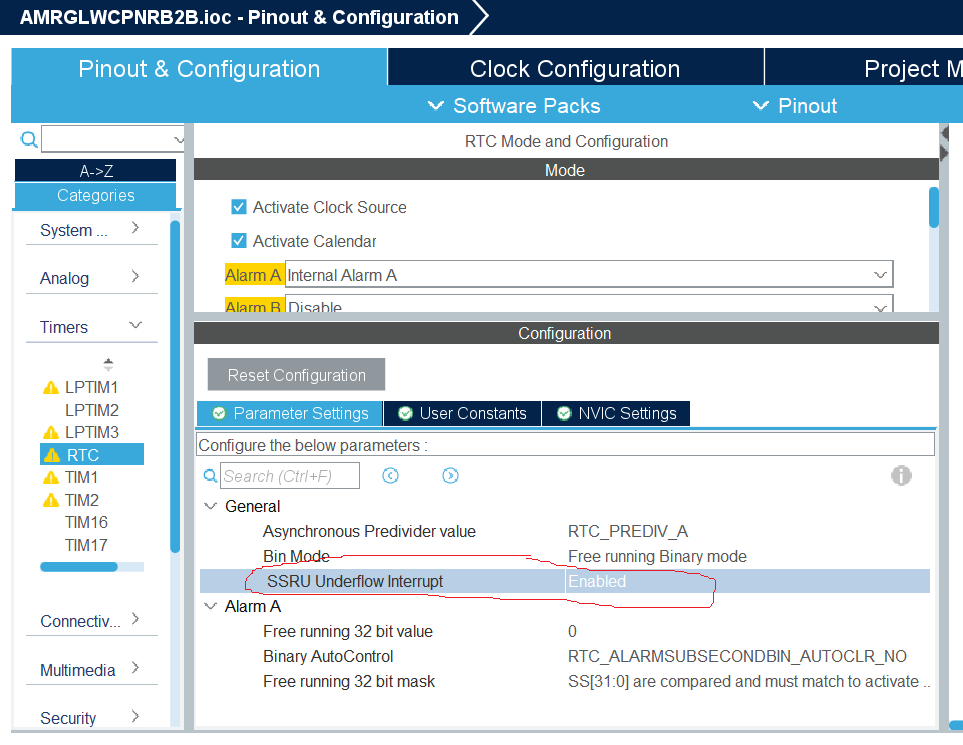

As Shown in images in 1st one SSRU underflow interrupt is enabled, but
"RTC Tamper, RTC TimeStamp, LSECSS and RTC SSRU Interrupts" is not enabled?
Is this case cause to reset of MCU?
2022-09-14 12:57 AM
I don't know, you'll have to walk the code and documentation to understand the mechanics of the failure.
