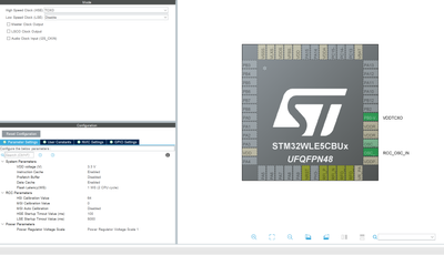

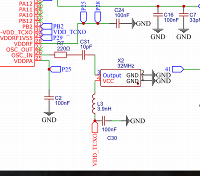

Hello there! I followed exactly what you mentioned on you board (please see below to see my work ), yet my TCXO doesn't work. There is no DC voltage at the output of the pin 30 or (PB0-VDDTCXO). The rets of the MCU is working fine
i have added a screen capture of the .ioc file
Any suggestions?
Thank you very much,
GUillermo

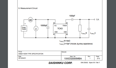

What is the Part# of your TCXO ?
Dear Tesla DeLoren,
Thank you very much for prompt response! I'm using the KDS Daishinku 1XXD32000MBA. STM support confirmed that this TCXO was acceptable for LoRa.
THank you very much,
