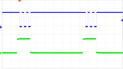

And I investigated further. Turns out, the IRTIM does not work as documented, as a simple NAND. Instead, IRTIM appears to work like this:
In other words, a pulse is "copied" (and inverted) from TIM17_CH1 to output, if at TIM17_CH1 rising edge TIM16_CH1 is high.
The probable reason for this scheme is, that at the output, negative pulses (as they intend to drive a LED from the lower N transistor) have always the same length as TIM17_CH1 pulses. It is anticipated that TIM17_CH1 is the carrier, i.e. higher-frequency input (if it would be plain NAND, it wouldn't matter).
Bottom green waveform is TIM16_CH1 and top blue is IR_OUT (btw. a bad way to call the IRTIM output, as one can't find it by textual search for "IRTIM"). Note how the output pulses are all uniform, even if the last of them "hangs over" beyond the TIM16_CH1 "envelope's" trailing edge.

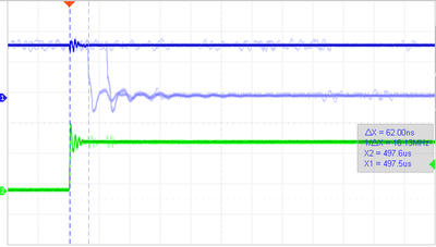

As I've already had things wired up, I was curious about which clock is used in the TIM17_CH1 edge detector. This is rising-edge waveform with all clocks at reset default: bottom green waveform is TIM17_CH1 and top blue is IR_OUT (note, that due to TIM16_CH1 envelope the output pulse is not always present with the input pulse, and this is an averaged display of many runs of the oscilloscope, that's why the blue waveform has "both polarities" after the edge):

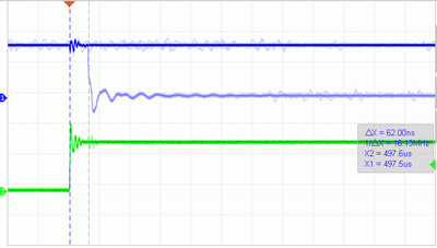

Difference is cca 1/16MHz (due to default HSI16 clock). At this point, there's only one single 16MHz clock in the whole mcu, so we've established that the edge detector's latency is 1 clock. Now let's set APB divider to 2 by setting RCC_CFGR.PPRE=0b100 (note, that due to the "timers clock rule", timers are still clocked by the original 16MHz):
Whoa.
A quick experiment with TIM17_ARR reveals, that this "double edge" is present only if TIM17_ARR is even (i.e. the real division ratio is odd); it returns to "single edge" if ARR is odd.
This is consequence of the fact, that IRTIM TIM17_CH1 is sampled at APB = AHB/2 clock, whereas TIM17 is clocked twice as fast, which at odd division rates results in the TIM17_CH1 edge's "phase" changing in respect to APB edge.
Using APB divider of 4 results in the expected "twice slower" waveform:
