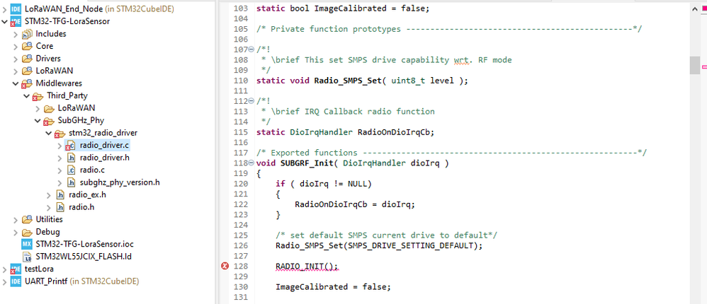

If I click in the error it navigates me to #define RADIO_INIT MX_SUBGHZ_Init, but no function is created by CubeMX.

Hello @RGili.1
You need to disable the MX_Subghz_init function visibility ( under Project Manager - Advanced Settings ) to avoid this error.
Please re-check and tell me if problem was solved or not.

2021-03-29 8:57 AM
Yes, problem solved disabling MX_Subghz_init function visibility.
Thank you!
