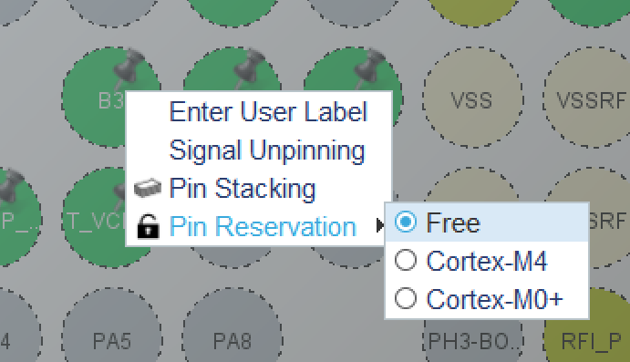

PC6 is not initialized since it's not assigned to either core. You need to assign it to the M4 or the M0+ core, in which case it will include the initialization code in that core's project. Right click the pin to get this menu.
