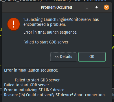

I have started to use stm32wl55 nucleo.
I try to debug a basic application.
I start by debugging CPU1 (CM4) than after booting CPU2 (CM0+) i run the debug for the second CPU.
But ST-LINK: Could not verify ST device!
error details :
Error in final launch sequence:
Failed to start GDB server
Error in initializing ST-LINK device.
Reason: (18) Could not verify ST device! Abort connection.
Any suggestion ?
Thank's.

I have the same issue on the STM32H747I-Eval board. Does not validate the CM4 core. I'd also like to know when this is being resolved.
We are many releases past 1.9.0. As of today, 1.13, so where is the fix for this issue?
