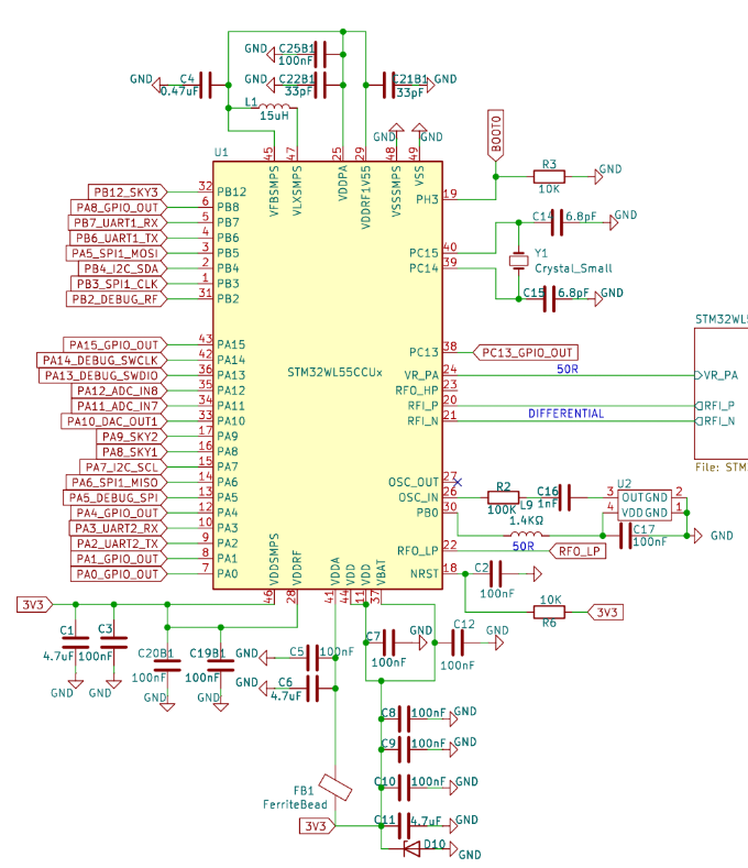

My team and I have been working on a custom radio board using the STM32WLx5 MCU. We got the PCBs fabricated and have assembled three boards so far. But all the boards (one after another) kept reporting "Target no device found" while trying to program using an ST-Link V2.
Our current assumptions have been:
Attached below is the STM section of the schematic:
(NOTE: We have made the NRST pullup resistor R6 as DNP and things still aren't working)
It would be of great help to gain some insight as to why this issue could be occurring.

2024-12-01 5:59 PM
Did you take a loot at our Nucleo schematics for reference?
Are you using a genuine STLink V2 ?
Also make sure all your software tools are up to date :STM32Cube/IDE/CLT/Programmer etc.
By default we tie our Boot0 to GND via a jumper.
There are associated option bytes for Boot0 Pin behavior but of course you need to be able to connect to the board for that.
Some circuitry to manually reset mcu would have been nice since there was no connection made for the programmer to reset the device.
Have you probed the reset line to see if its toggling maybe the mcu is constantly resting. I would probe around to see what insight you can get at the hardware level, voltages states etc. If you have any other boards I would assemble and test in steps starting with absolute minimum to get the mcu powered , no crystals , let it use internal oscillator and see if you can connect to it.
2024-12-02 5:41 AM
Yes, we have referred to it in the schematic design phase. We have also referred to MB1720 and MB1849. Our implementation matches with that of STM.

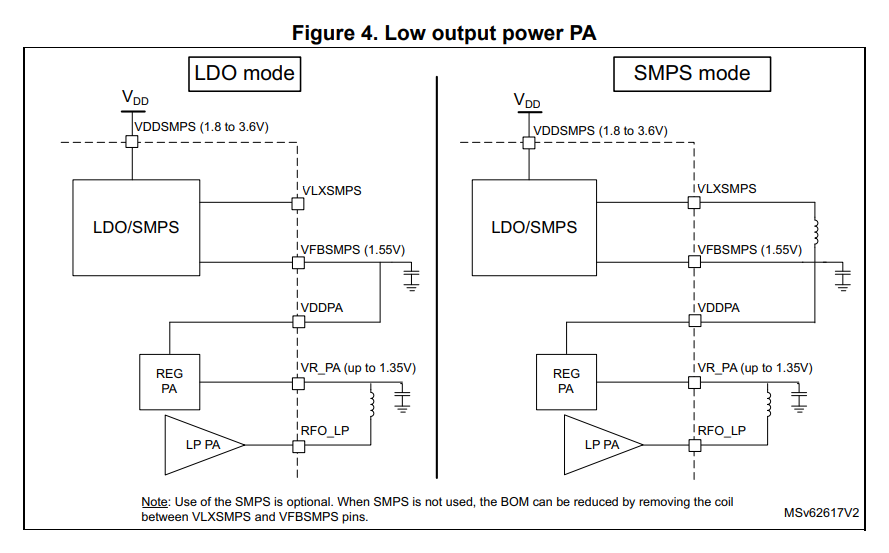

We probed along a lot of pins, especially the power section. Looks like the internal SMPS and LDO are functional. We obtained all voltages as mentioned in the below image (obtained from STM32WLE5 Datasheet)
