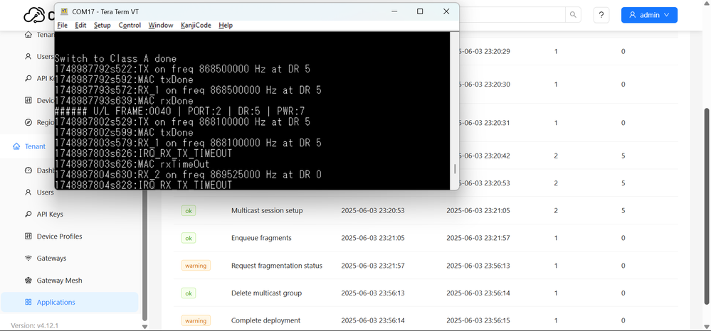

The LoRaWAN_End_Node from LoRaWAN_FUOTA Project (STM32Cube_FW_WL_V1.3.1) is used with ChirpStack as a network server (supports the FUOTA Package V1).
The Multicast session runs and receives the Downlink of all the Fragmented Packets from the server.
The issue appears after receiving the last packet. Seems that the Firmware doesn't recognize that the downloaded firmware is complete, and it should begin building it.

Trying to find a way to let the Firmware swaps to the new version rather than flip back(after the expiration of the Fragmention status request) to the old Firmware:
Tracing the logs, there is no sign of FRAG_DECODER_IF_OnProgress and FRAG_DECODER_IF_OnDone being called. Hence, FwUpdateAgent_Run() never runs either.
Is there a way to fix this without the need to run an external fragmentation server(to implement the proprietary protocol)?

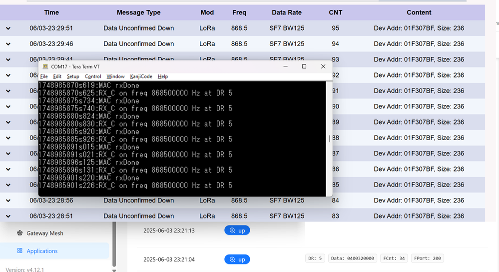

@STTwo-32 Thank you for your response but in my case, the current download file doesn't rebuilt, the firmware just hang on the last packet(CNT = 95 in the 2nd photo) then after fragment-status-request send from the Server(which doesn't get any response from my Node until it reaches timeout) the Firmware switches back to Class-A.
I can see inside LmhpFragmentation.c the function LmhpFragmentationOnMcpsIndication, which has the case FRAGMENTATION_FRAG_STATUS_REQ which should be called when the FUOTA server asks for the status, but it never runs!!.
