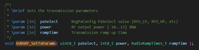

I would like to understand.According to the function documentation
the range is -18dbm to 13dbm . However my radio specs say it can support 22dbm TX (US915)
Is this a Gain/attenuation to be applied to the total 22dbm ? .
Is RFO_LP 14dbm and RFO_HP 22dbm ?
How can I have a estimated practical value ? I mean 6dbm should give me TX current of 20mA @3.3V ?. By default I get around 110mA
I want to limit the final TX power to 6dbm.
