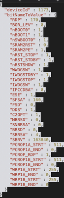

Hello @maestrmx19
Please add all your option bytes output here. Also, take a deep look to this wiki page. It should be really helpful.

2024-10-18 9:35 AM
2024-10-18 9:48 AM
They are not really visible here.? Could you please use the GUI of CubeProgrammer.
Best Regards.

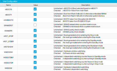

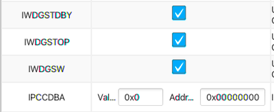

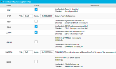

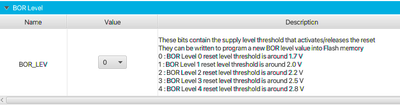

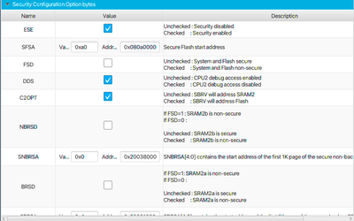

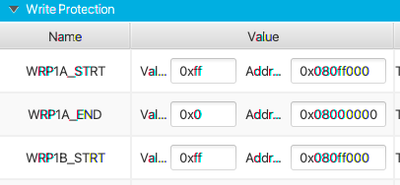

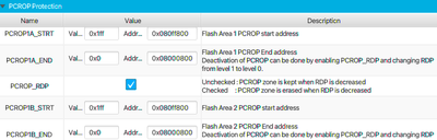

Ok I'm sorry @STTwo-32,
Heres the options bytes:
BOR LEVEL:
USER CONFIGURATION:
SECURITY CONFIGURATION OPTION BYTES:
PCROP PROTECTION:
WRITE PROTECTION:
Best Regards.
