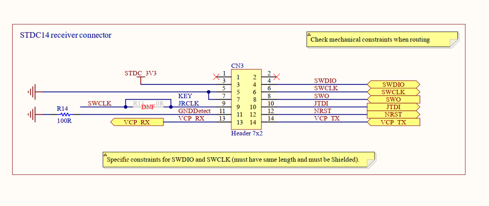

I am using STM32WBA5MMG in my design. This the development board schematic. Below image is from development board schematic.
As per the constrains , SWDIO and SWCLK must be length matched. Also need to provide a shield.My questions are given below.

These are not usual requirements for SWD !

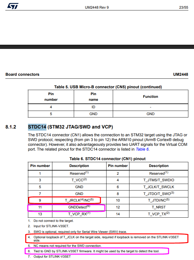

May I know what you mean by GNDDetect and KEY JRCLK signal?
2026-01-19 4:19 AM
I found a description of these in the STLINK-V3SET User Manual:
