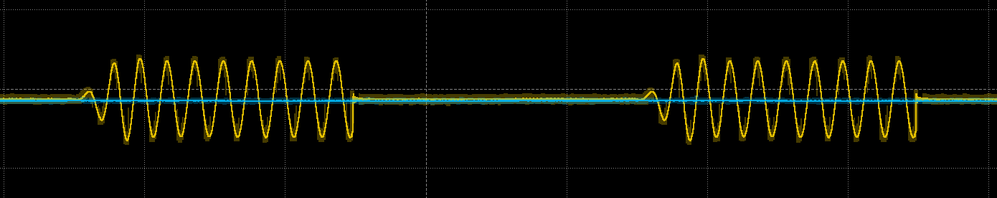

2025-03-27 4:16 PM
I have tried my best to follow your instructions for implementing some audio processing on the audio samples.
I am trying to access the audio samples via CODEC_NotifyDataReady inside tmap_app.c. I have tried to make a very simple loop which tries to mute the left audio channel. Assuming the data is interleaved left and right.
void CODEC_NotifyDataReady(uint16_t conn_handle, void* decoded_data)
/* When only one channel is active, duplicate it for fake stereo on SAI */
uint32_t i;
uint16_t *pData = (uint16_t *)(decoded_data); /* 16 bits samples */
if(pData == (pPrevData + 1)){
/* we start receiving two channels */
Nb_Active_Ch = 2;
//LOG_INFO_APP("2 Channels Active");
pPrevData = pData;
if (Nb_Active_Ch < 2)
//LOG_INFO_APP("1 Channel Active");
for (i = 0; i < Sink_frame_size/2; i+=2)
/* decoded_data is organized with a decimation equal to 2, so we duplicate each sample */
pData[i+1] = pData[i];
for(i = 0; i < Sink_frame_size; i+=2){ //Trying to mute left channel
pData[i] = 0;
} Doing so results in the program freezing with an analog output looking like this:
Looks like one of the channels (blue signal in oscilloscope) was succesfully muted before the program froze. I can't explain why the yellow channel appears the way it does.
I am running the STM32Cube_FW_WBA_V1.6.0 on the STM32WBA55G-DK1. The application example running is the BLE_Audio_TMAP_Peripheral.
Any suggestions would be greatly appreciated. My audio processing does not have to happen here, i just need to know where i can safely access the raw audio samples.
2025-03-28 1:43 AM
Note that Sink_frame_size is the total len used by the DMA (in samples), meaning it contains 2 x LC3 frames (20ms of data in the example). But we are working with half and full transfer DMA interrupt (10ms frames), so you have to use (Sink_frame_size / 2) for your loop.
Additionally, CODEC_NotifyDataReady() is called for each LC3 frame decoded, meaning there is 4 different pointers provided (same as provided in CODEC_ReceiveData because 1 ch / CIS)
Thus, you have to check that pData is on the left channel, so here is my proposal :
if ((pData == aSnkBuff) || (pData == aSnkBuff + Sink_frame_size/2))
for(i = 0; i < Sink_frame_size/2; i+=2){ //Trying to mute left channel
pData[i] = 0;
Best regards,
