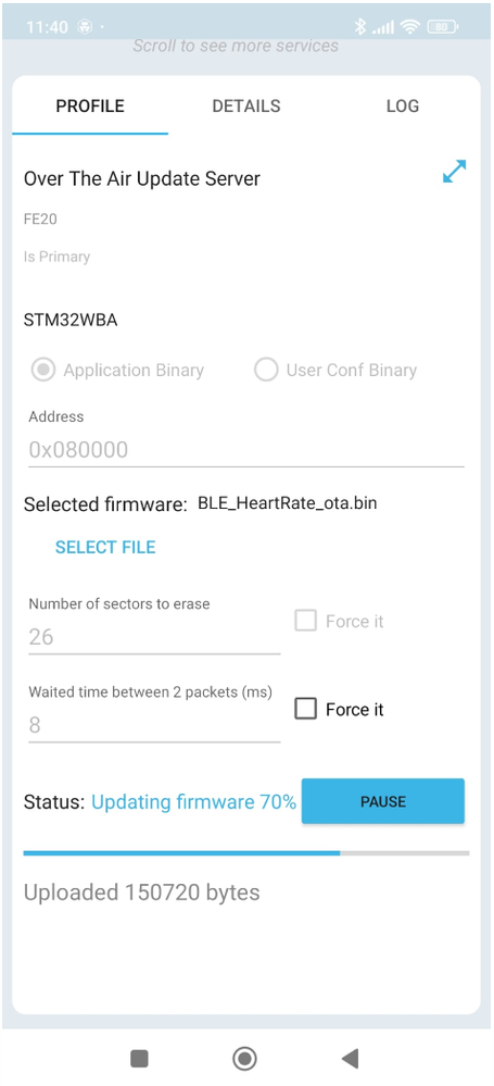

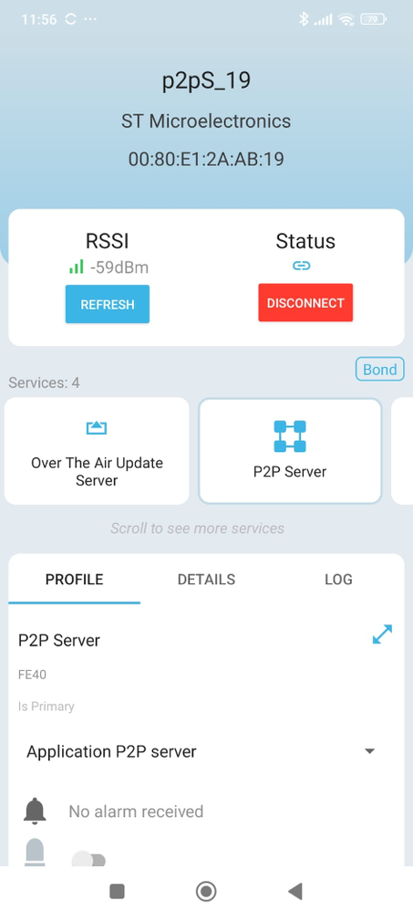

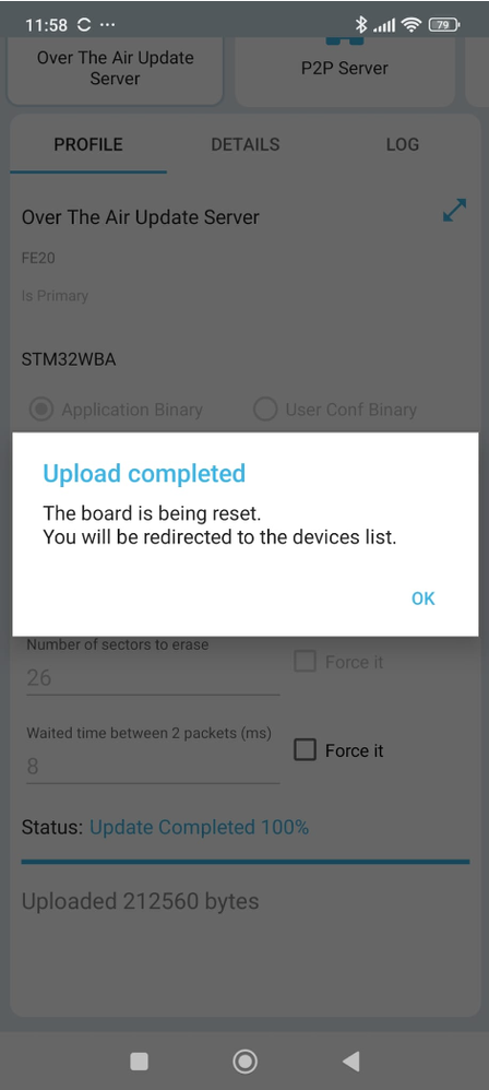

I'll attach my binaries for you to test.
You can also check that you have the latest version of ST BLE Toolbox (v1.4.2).
