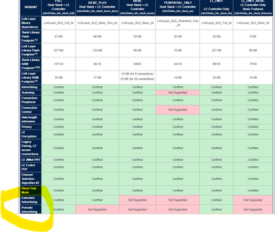

2025-11-07 4:13 AM
What about WBA65?
Also, stack is certified with PAwR?
https://wiki.st.com/stm32mcu/wiki/Connectivity:STM32WBA_BLE_Stack_Integration
2026-01-29 3:06 PM - edited 2026-02-04 12:54 PM
It will do Periodic Advertising (5.0). It will not do Periodic Advertising with Responses(5.4). It will do Encrypted Advertising Data (5.4).
