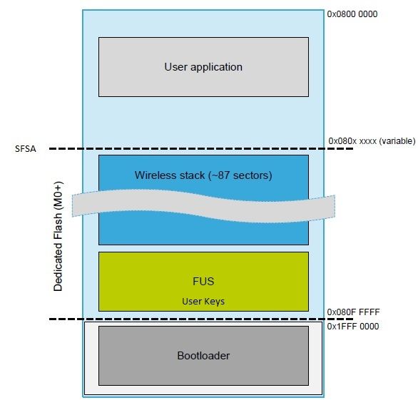

You can look this wiki page which talk about the FUS and you can refer to AN5185. According to this documentation, the FUS start address is 0x080F4000 and the memory between 0x080F4000 and 0x080FFFFF is reserved for the FUS. The wireless stack is under the FUS, in your case if you are using the BLE Full stack, it will be located between the 0x080CE000 and 0x080F4000. The safeboot is an independent part of the FUS that manages specifically one case: option bytes corruption. It can be installed on STM32WB devices where FUS V1.1.0 or FUS V1.1.1 is present. No need to use it on parts where FUS V1.2.0 is present (as these parts already have the latest Safeboot version).
You have erase the wireless stack, that's why your device doesn't advertise. You can refer to this wiki page which explain how to setup the board.

The address for the FUS:
In the C:\Users\me\STM32Cube\Repository\STM32Cube_FW_WB_V1.15.0\Projects\STM32WB_Copro_Wireless_Binaries\STM32WB5x\Release_Notes.html link page the address is: 0x080EC000.
In the link you sent (which seems more logical) it is 0x080F4000.
2023-04-26 7:03 AM
The address 0x080EC000 in the release note is the download address and the address 0x080F4000 is the address where the FUS is running.
