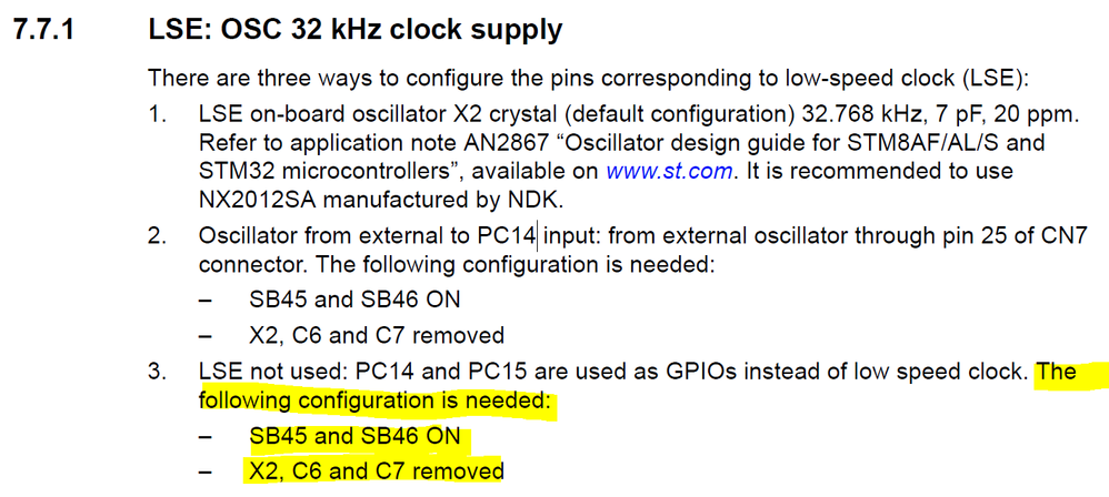

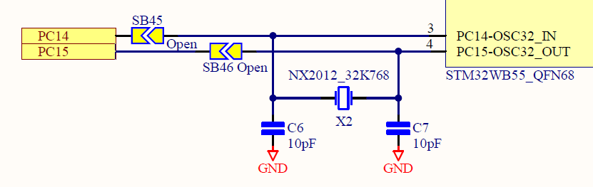

PC14 and PC15 aren't connected to an output on that board by default. Need to close some solder bridges and remove the LSE crystal.
PC13 should work as far as I can tell, if it's not being used by the RTC.

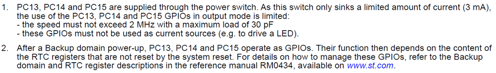

PC15 has limited current capability, but shouldn't be an issue for a CS pin.
See notes in datasheet on PC15. RTC settings will override GPIO settings.
Also ensure PC15 on your board is free and not acting as OSC32_OUT.

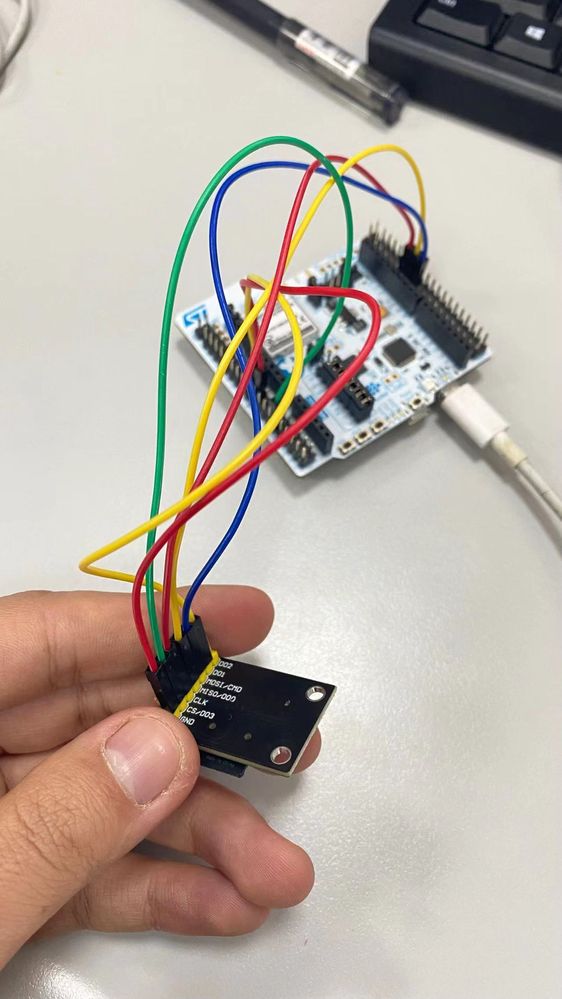

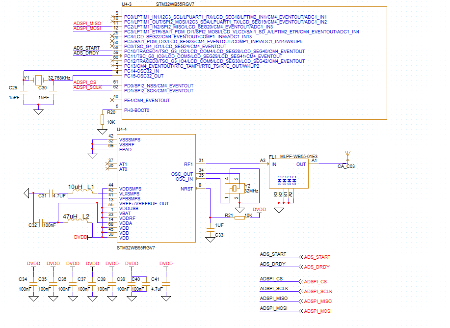

The cause of this problem is that my schematic is wrong.I just pull up the CS pin in TF card module.I forgot to connect the pin CS of the TF module in the spi mode.So I remove the LSE and I use jumper cables to connect pin PC15 and pin CS. I use the official routines which named FatFs_uSD_Standalone. I commented out the LEDs and used only spi and FATFS. But it doesn't work.The schematics are shown below.In my own project, I am not using LSE and configure according to the datasheet.I don't know how to proceed...:face_with_tears_of_joy:
2022-03-12 6:42 AM
I have debugged successfully, thanks again!
