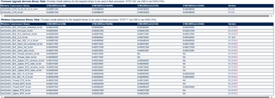

The STM32WB55RCV6 is using the same .bin files for FUS and Stack as the NUCLEO-WB55RG. But the install address is not the same between both MCU. So, please update the stack and FUS using the last version of the .bin files available on the STM32CubeWB V1.21.0. Use the starting Address for the upload of the .bin files mentioned in this table:

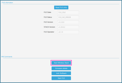

Finally, after uploading the Stack and FUS, don't forget to start your Wireless stack using the "Start as Wireless" button:

I followed the advice given above and I now receive the WIRELESS_FW_RUNNING event, so that was a great help! *
From the notes above I learned I needed to use the WIRELESS tab on the PROG tool (a small wireless antenna pattern is shown on the icon, which is on the left, at bottom). In this tab, you can enter the name of 2 binary files to load into flash. One for the firmware update service, FUS (stm32wb5x_FUS_fw.bin, loaded to 0x0803_c000 ) , and one for the BLE wireless service, WIRELESS ( stm32wb5x_BLE_Stack_full_fw.bin, loaded to 0x0801_c000) . Each has their own base address embedded in the binary. After loading both binary files, stay on the same tab, and look over on the right hand side to see info about the FUS version, and below that is a button to START WIRELESS. You must press that button, instructing the firmware to start the WIRELESS service first, not the FUS service.
