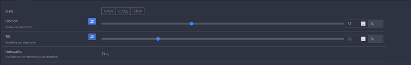

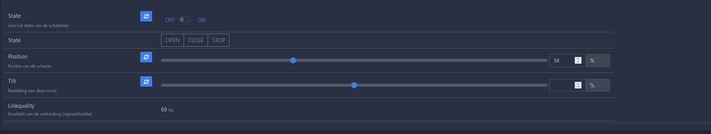

The last few days I have been trying to get Zigbee working on my STM32WB55CGU6 and I can now switch on and off a light! But the more difficult thing to get working is the WindowCover. Below you will find the image where my STM32 has connected to home assistant and I can turn the led on and off with the top switch. The problem I now have is sending the other attributes in particular the position. Below you will find my app_zigbee.c file

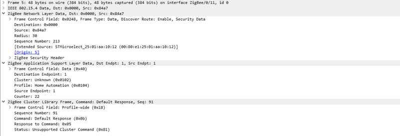

I still haven't tackled this problem and it's bugging me. I've bought a CC2531 Zigbee sniffer and can now see what's being communicated between my home assistant and the stm32 chip. When I change the position in the picture below a command is send out which you can see in the other picture.
I can see that the status is 'Unsupported Cluster Command' but I think i got everything setup right. The device got interviewed so everything should be set correct right?
