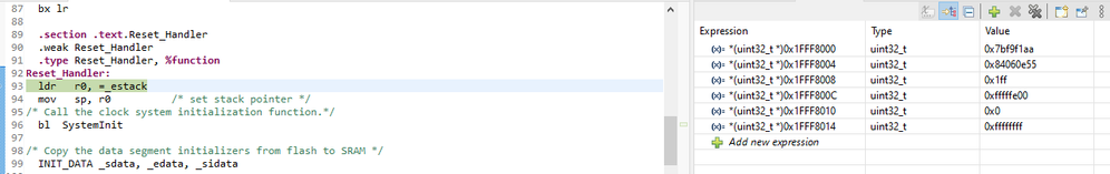

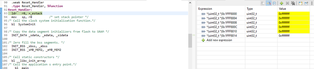

Some strange behavior is happening when debugging our firmware through STM32CubeIDE, where it erases the option bytes upon flashing the firmware (0xFF @ 0x1FFF8000 onwards). The debugging session still launches ok and the firmware appears to be flashed correctly and working as intended.
This is especially annoying as it triggers the flash option bytes protection where it secures the memory and I have to manually restore it using the FUS safe boot mechanism. Our firmware is designed to go to shutdown mode each time which triggers this, so I can't do any work on it right now.
At first I thought it was a problem inside the firmware, but if I flash the ELF / srec artifact through the STM32CubeProgrammer directly, the problem goes away??
This never used to happen - took a break over the new year and I've come back to this problem.
Tried:
Dummy firmware:
Real firmware:
Any ideas? Thanks

Reverted back to the launch config I had before, but no difference (only unticked resume and stop on main). The frequency is set to auto on both configs too.
Tried different reset types with no difference.
For first scenario, letting CubeProg download program and not IDE, this works - I can terminate and restart debugging as much as I like, no OB's erased.
For second scenario, letting CubeProg download and run, this also works - I can step through, reset (all types), run and it all works fine, no OB's erased.
There were some code changes in our FW since I last debugged it in the CubeIDE, but I don't get why CubeProg works if it was that...
2023-01-04 11:00 PM
There is a specific line of code that if I comment out the debugging works correctly, but it's relating to a terminal, nothing to do with flash memory / OB's.
Again, the exact same firmware built works if I flash it through CubeProg, so I'm still not sure what's happening - maybe circuit / voltage related?
