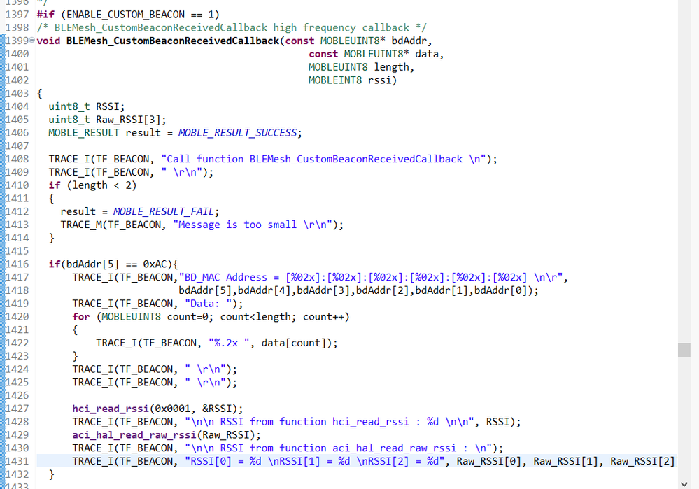

0693W00000D0CPyQAN.pngIs my code OK
I don't understand about connection handle in function HCI_READ_RSSI
At least, I can get signal through my room about 20 meters
Remi QUINTIN
The connection handle is the handle used to identify the connection.
This connection handle is returned in the connection_complete_event once the connection is established.

Associate II
