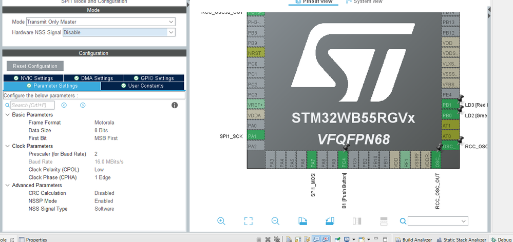

Hello. I am trying to setup SPI1 on the STM32WB55 nucleo board. I have setup the nucleo board with the default peripheral configuration using STM32CUBEMX and I have enabled SPI1 Transmit Only Master mode:

I tried your code after quickly setting up a cubeMX project for this nucleo.
It is working.

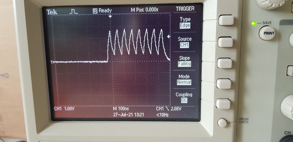

Hello. Thank you very much for the response. I am big noob debugging hardware and never really had an opportunity to have a look at SPI through an oscilloscope. I have managed to capture some sort of signal on clock pin with trigger option on my osciloscope. Please see the image below:
Does that look like a decent SPI clock? I have measured the time difference between the start of the spike and end of the spike and it looks like 60ns
2021-07-27 5:13 AM
Near 62.5ns + 8 spikes, it works.
The signal is not square at all.
Maybe your probe/scope need to be calibrated.
2021-07-27 5:17 AM
Once I have set the prescaler to 256, the signal is square. Now the clock period is 125Khz and that is correct since the CPU cluck frequency is 32Mhz/256 = 125kHz. Maybe my scope is too old to handle 16Mhz? Anyways, thanks. That confirmed the SPI is working as expected
