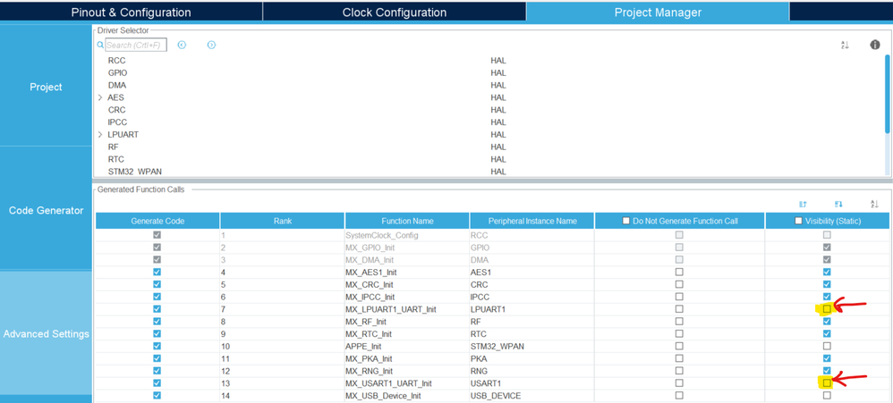

2021-08-04 5:31 AM
Hi, I'm getting a very similar error while linking. Have you managed to solve it?
c:\xxxxxx\stm32cubeide\plugins\com.st.stm32cube.ide.mcu.externaltools.gnu-tools-for-stm32.9-2020-q2-update.win32_2.0.0.202105311346\tools\arm-none-eabi\bin\ld.exe: ./STM32_WPAN/App/app_thread.o: in function `APP_THREAD_Init_UART_CLI':
C:/xxxxx/Debug/../STM32_WPAN/App/app_thread.c:647: undefined reference to `MX_LPUART1_UART_Init'
collect2.exe: error: ld returned 1 exit status
make: *** [makefile:73: test_STM32WB5MMG.elf] Error 1Cheers,
Nico
2021-08-04 6:19 AM
Found it. The generated code declares the UART init functions as static by default.
