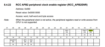

Hello @AndreasC and welcome to the ST Community :smiling_face_with_smiling_eyes:.
the APB2 is the clock bus for the TIM16:
Best Regards.
STTwo-32

2024-07-23 5:25 AM
You could save yourself this answer ;) It is not clear to me which clock bus the TIM16 is on (APB1 | APB" etc.) ...
2024-07-23 5:33 AM
Best Regards.
STTwo-32
