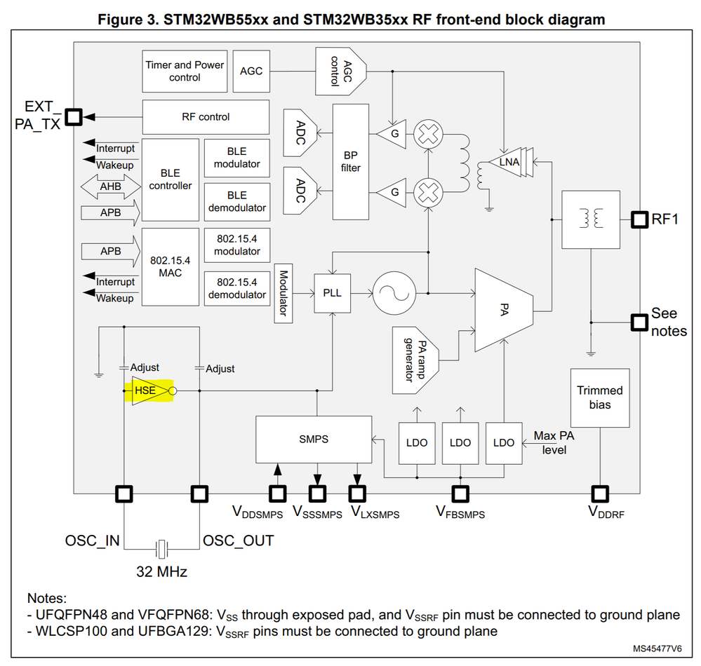

The RF front end requires a 32 MHz HSE as a clock source. Probably the HSI does not meet the high speed timing requirements for Bluetooth.

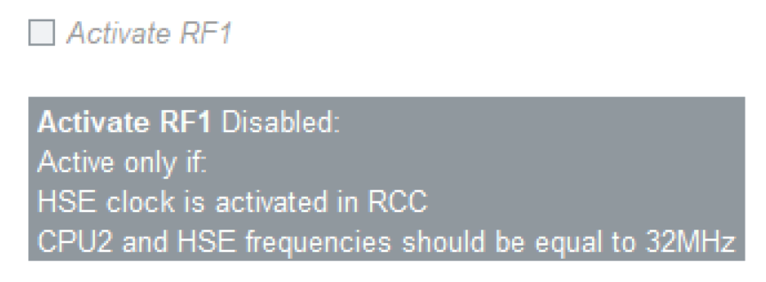

If you hover over something in CubeMX that is disabled, it will usually tell you why. In this case, it does exactly that.

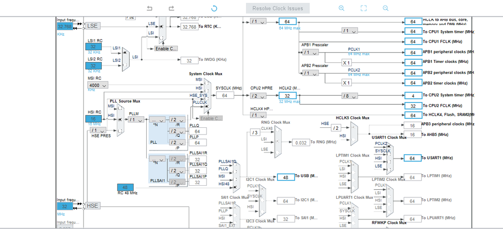

Yes. I understand it. But, I have another doubt regarding this. When I set the HSE as external ceramic/crystal oscillator, RF gets activated, but in the clock configuration window in Cube MX I set system clocks such that, HSE is not used anywhere in the clock configuration (HSI as CPU clock and LSE as RTC wake up clock and the system works in the P-Nucleo-WB55 development board. How does this happen when I set HSE as enabled, but not used in Cube MX clock configuration?

Is HSE activated?
Are CPU2 and HSE frequencies set to 32 MHz?
If not, show your clock configuration screen.

I have activated it,but not using it to clock any CPU. I am not using it anywhere in clock configuration.
2021-01-09 6:18 AM
Looks like you've satisfied the requirements. I don't see any issues here. It doesn't say CPU2 should be clocked from HSE. Although perhaps this is a bug, no idea.
