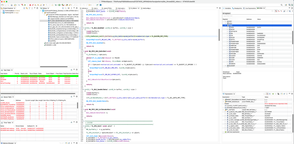

Can you confirm that your screenshot in your post where the TL_RefTable contains the hardfault keyword is taken with the BLE Full Stack v1.15.0.3? If it's not the case, can you share a screenshot which contain the TL_RefTable and give the corresponding stack version?

Thank you for that information. Yes, the TL_RefTable from the original post is v1.15.0.3. Here is another one from v1.16.0.4. I just took a screenshot of the state of the IDE. TL_RefTable is in the lower right corner.
Just as an FYI, the code I am running does not ever write flash.

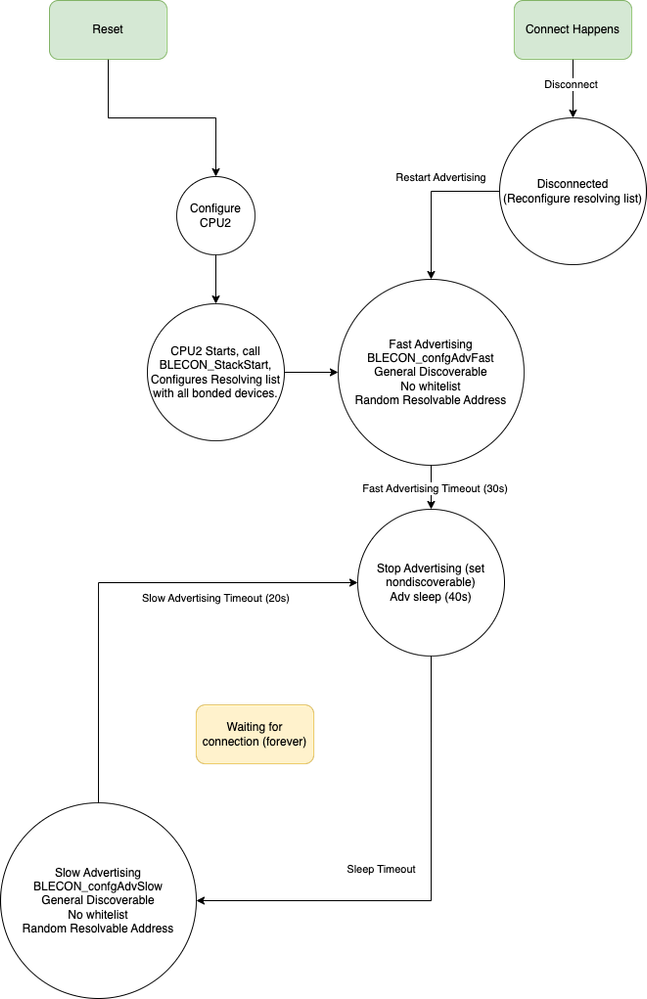

I have created a basic flow chart of what our device is doing in this state.
At the end of a connection, we fast advertise for a bit, then take a break and shift to slow advertising. We enable and disable slow advertising until a new connection is established. We are a battery limited device, so we are trying to optimize current consumption while not connected to anything. We are not connected when this issue occurs, we are just advertising.
