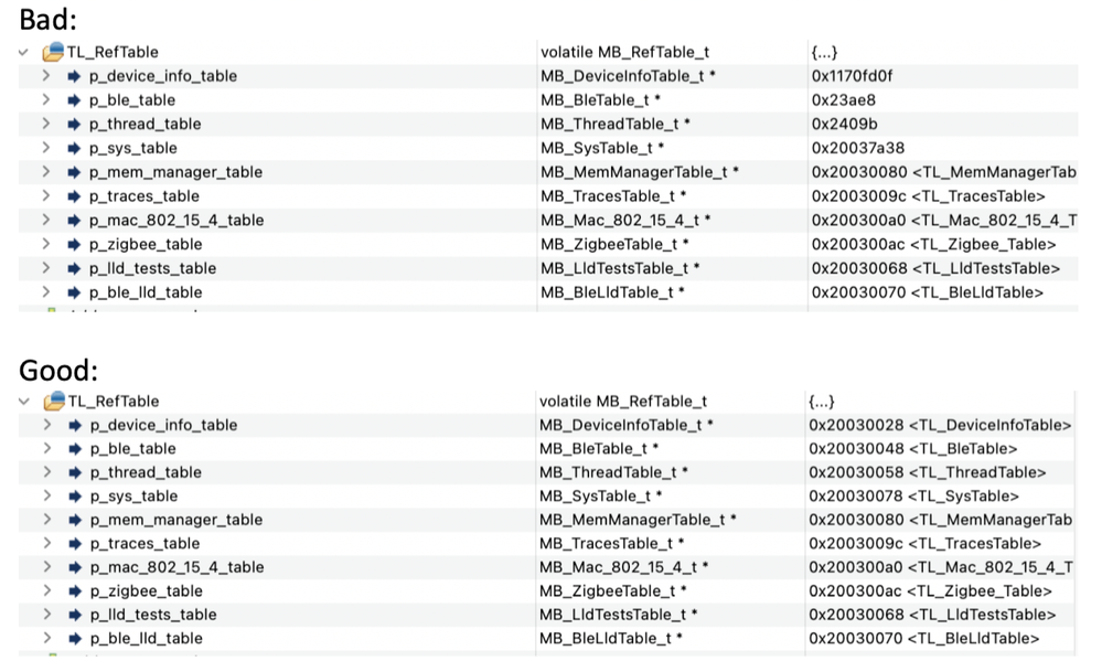

Ive seen this issue in various different forms over the last 2 years and it seems like CPU2 is corrupting the TL_RefTable structure while configuring advertising. We are using v1.15.0 of the stack on a STM32WB55. This happens every few hours in the following sequence.

According to your screenshot, you have an hardfault, indeed when the CPU2 enters in the hardfault interrupt handler, it writes the following data (extract of AN5289:(

Yes, the hard fault is generated when we deference the bad pointers in TL_RefTable the next time we attempt to send a command to CPU2. The problem is that CPU2 is corrupting the table. See the table in the above screenshot.
Also, I tried this in v1.16.0 stack and the problem is still there.

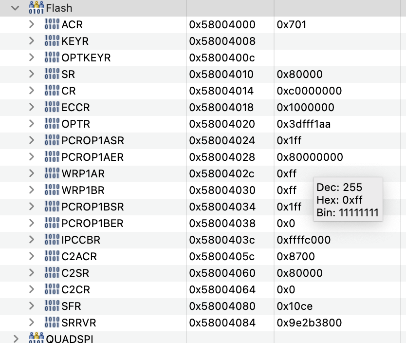

Which stack and which version are you using? When the hardfault occurred, can you check flash register value (FLASH_C2SR (CPU2) and FLASH_SR (CPU1) register)?

Hello, sorry for the delay. This issue takes a while to duplicate. The FLASH_C2SR is 0x80000 and FLASH_SR is 0x80000. What is the significance of the flash registers?
Another note, We are using LE Privacy (random resolvable addresses) and if I disable it and just use my static random address this issue goes away.
